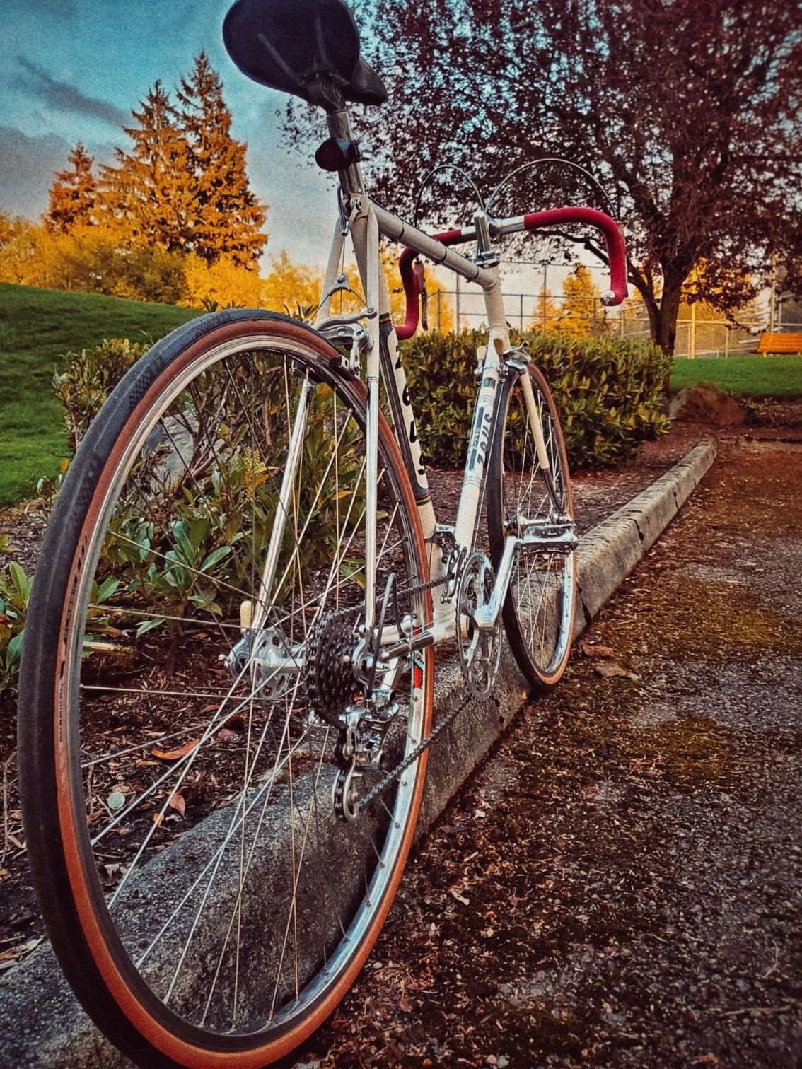

A little edit I made of the Zeus a few weeks back.

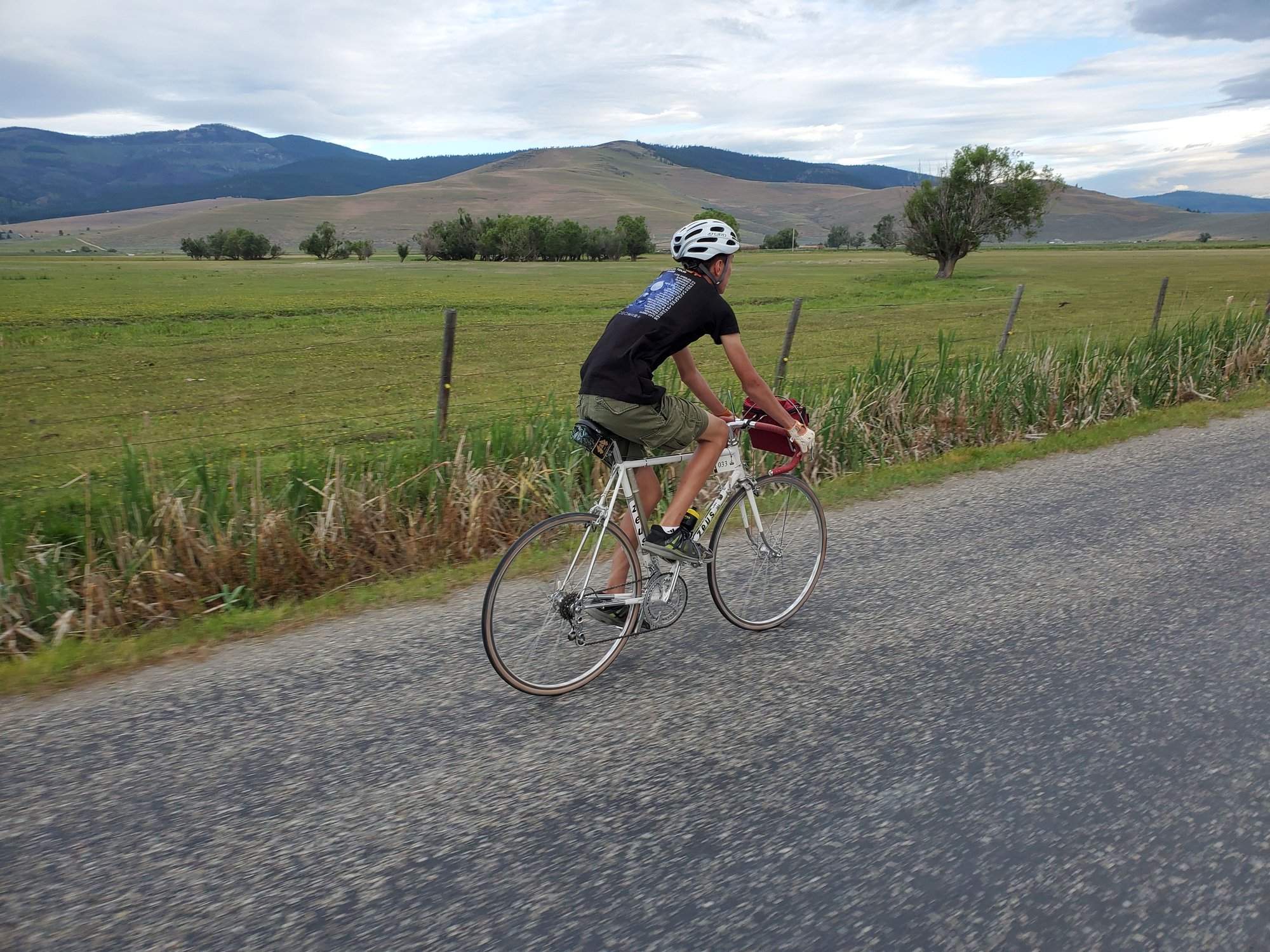

Update:
Well Thomas and Zeus made it back to Montana last week. Thomas rode two days of Cino on the white bike, and both performed admirably. He didn't need any low gearing, making due with a 40 front/26 rear. He made a bunch of new friends throughout the weekend, and got plenty of encouragement.
The only problem he encountered was a punctured water bladder in the front bag. Must of made contact with a multi-tool with all the bouncing around.
On Friday we had a real treat,, when the original owner showed up at the check in and bike show. Thomas was able to assist questions and hear stories about the bike.
So, in less than a year, Zeus has kinda gone full circle. After giving it a service and some elbow grease, it has a second wind. I am happy to see my kid take on this project and be proud of it. We still have plenty of Summer left here, so hopefully we'll get out for some great rides in the Cascades.
