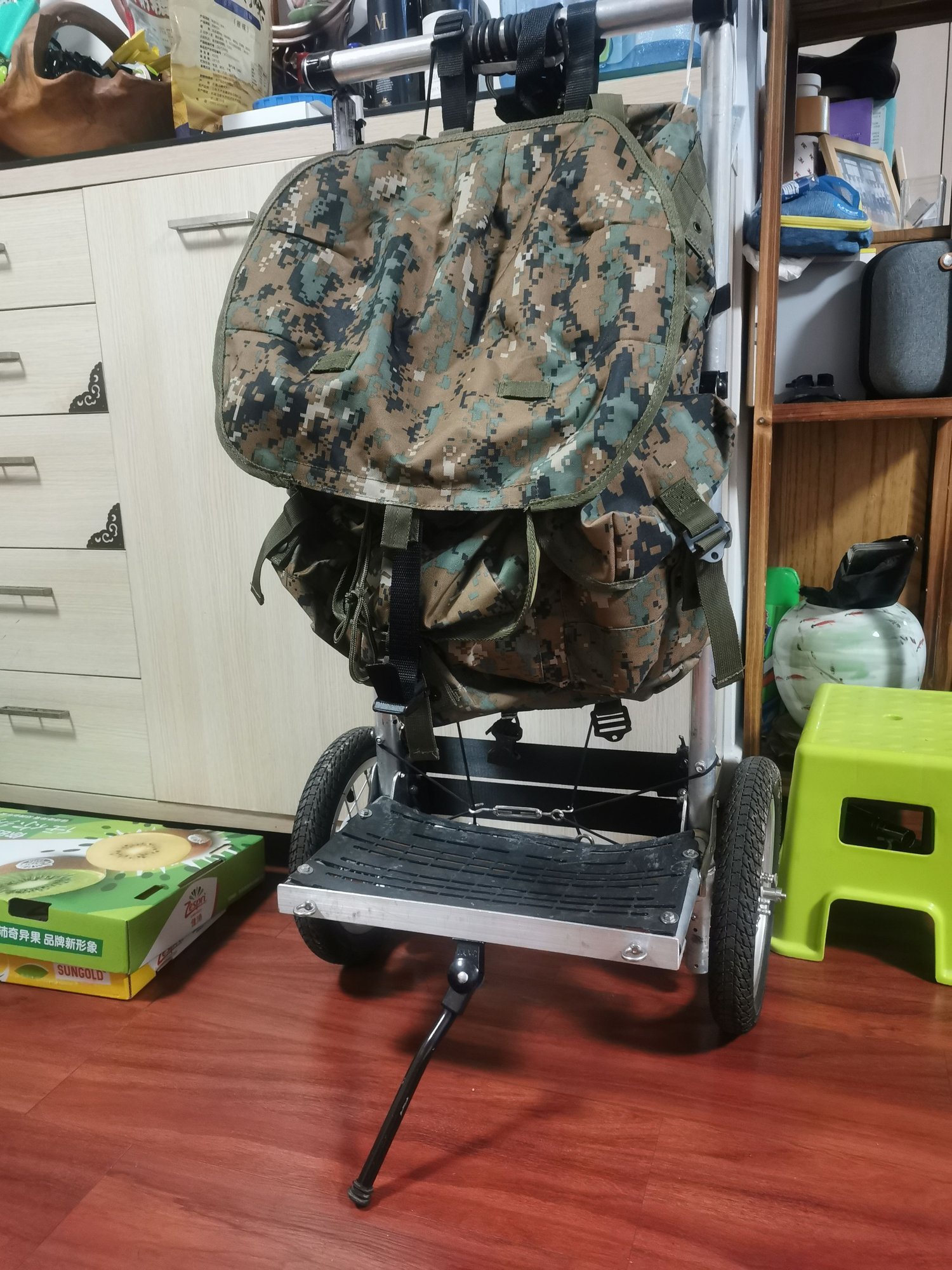

Originally Posted by jdoff View Post
Could you say where you found the flex connector that fits into the Burley hitch? I think I found most of the other parts you've used.
Product: Folding Hand Truck — 110Lb. Capacity, Aluminum, Model# KC10061
12 1/2in. x 2 1/4in. Tire with 5-Spoked Wheel | Pneumatic Spoked Wheels| Northern Tool + Equipment
https://www.amazon.com/dp/B0038LPOD6
I'm very interested in this project, because I like the idea of the Travoy but not the expense. Do you have bags that you use with this, or do you just haul boxes?
I like what you've got going here, I'm planning a trailer build to transport my tricycle based on the Ironton 40"x48" trailer kit from Northern Tool. I think it will be just about perfect for less than half what a full size trailer costs at Tractor Supply (sorry i didn't include a link , i suck at that stuff)

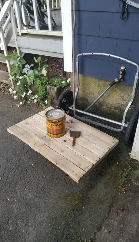

Simple, lightweight, slim for storage
Using only materials I had on hand I created a very load capable trailer that with a fitted tarp and small cleat style straps...I have a versatile, adaptable trailer for any of my needs.
Pallet
Nuts, bolts and washers
Oak stain
The landfill pick pile free child carrier
Removed the shell and using pallet boards the dimensions were perfect. I trimmed them to 40" or 44" length and utilized 3 others for cross supports beneath
12, 3/8" Diameter bolts, washers and lock washers.
Undercarriage visual
The hitch assembly that came with the trailer child carrier
Deck removed to stain as one piece
Stained(liberally), clear coat(heavy), reassembled
Love the versatility the open deck allows
Already working for me
Heavy load full of camp stoves and fuel
Sleek, slim, lightweight
Thanks for looking.
Any feedback, opinions and thoughts always welcome...I would love to hear what anyone might include, add, eliminate, do entirely different...let's hear it lol!

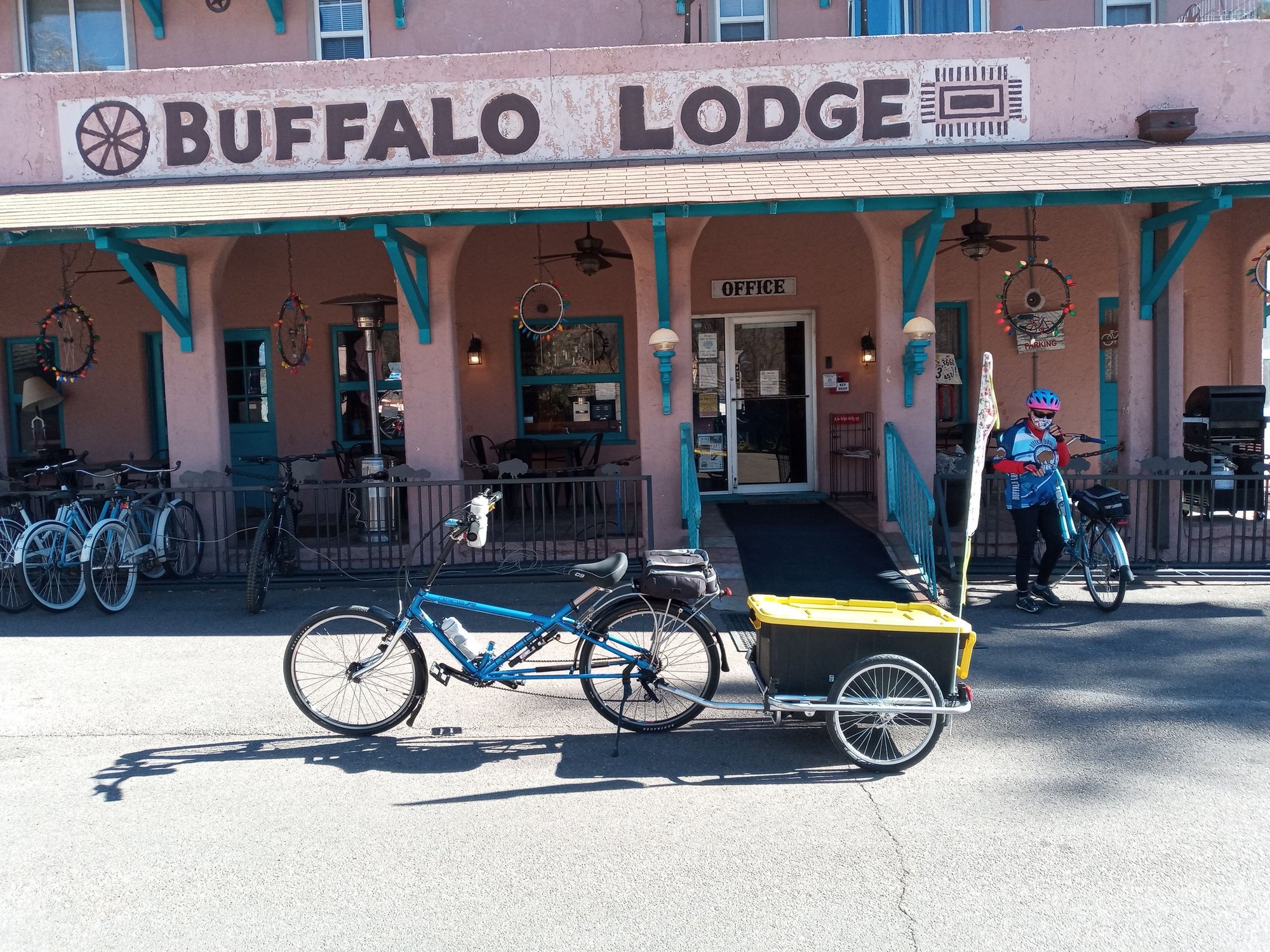

Bike trailers are good but they can be a bit weighty and the hitches tend to be poor. Mine is the Avenir Cleveland.
But I wanted something bigger. So I made this.
Carrying a lot of weight is fine, the secret is to keep it as low as possible, and don't put all the weight on the tail.
Pallet
Oak stain
Thanks for looking.
Nice! I used cedar fence boards to form the base of my Burley mod. The 2x4s might get heavy, though you did seal them. I think stipping the trailer down to make a flatbed is an awesome expansion to a bicycle's capabilities! I love my trailer, and it takes a beating. Great job!

Just built up this homemade from a old Burley Child Carrier Trailer on Feb. 1st. Photo is the "successful test ride" on Feb. 2nd. It pull's easy will be using for FOOD and larger items, My old truck is having expensive transmission and other problems so we will be going CAR FREE soon and needed a trailer as on our meager retirement income we can't even DREAM of affording a better truck! Did some changes to the way I added support bracing for the tub. Used 1" wide, 3/8 in. thick steel bar stock, 3 pieces 1 full length to make a support spine, then 2 short going across the wide part, used U-bolts with Wing Nuts for holding on the Tub so it comes off and on quickly! (added 2/20/21).
Take Care, Ride Safe, have FUN! :)

This is my homemade "Burley Travoy style" made from an external frame backpack and a heavier duty one made from raw components.
