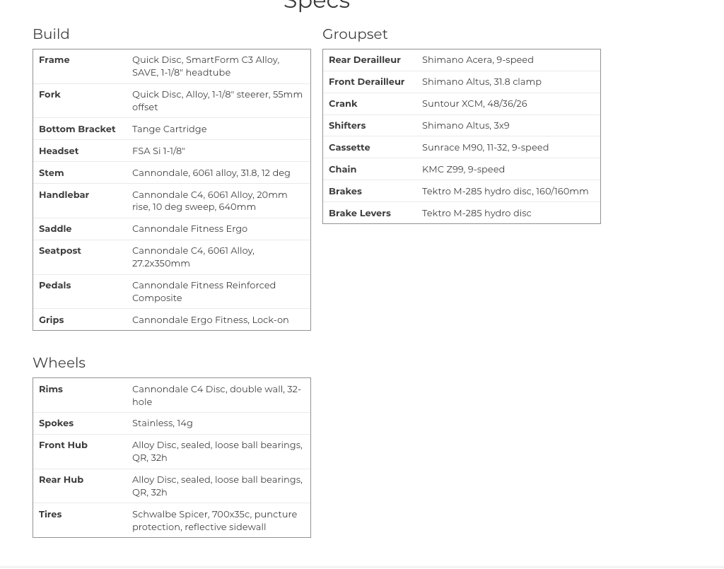

Depending on the frame clearance.. going to different size wheels/tires will likely change the location where tires are nearest the frame.
With wider tires, there may not be enough frame clearance.
Another issue with changing the wheel size, geometry of the bike may be affected; depending on your specific ride, may or may not have desirable result.
cat0020 is offline

Originally Posted by Sempervee View Post
Greetings, Have an Urban hybrid Cannondale with hydraulic brakes that I think might make a good kit ebike and fits me well. The only issue is that finding a kit for 700C wheels is very challenging. My question is can I change the wheel size to accommodate the kit sizing of 26 or 29 inch tires? What is involved other than the obvious new wheels and tires? Anyone ever do this? Thanks -
NO.
To be specific, a 29" wheel is a 700c wheel
A 26" wheel is going to cause all kinds of problems.
The theoretically, you can put a 650b (27.5) wheel on it, but I'm not sure why you would.
you could give us a link to your bike for specs.
Typically with hybrids, I can put pretty large tires on there (i.e. 29"). If there is clearance, there is no real downside to going bigger.
on the theoretical side, if your frame fits it, you can put a fatter 650b tire than the 700c and keep the same diameter - which is ideal (although going bigger doesn't have much of a downside, going smaller does).

Here are the Specs and I measure the drops out's Front is 100MM Axel 10mm Rear is 135mm. Thanks for all your insight. I like the 700 so Staying with the 29 inches would be fine.
Axel 10mm

As mentioned above, both 28" and 29" are by definition ISO 622 (700c), and should fit on your bike if the rim itself isn't too wide.
In some cases you can swap between 26" and 700c. In particular, a 26"x2.1 or so will be close enough in outer diameter to swap with a 700c x 25mm tire.
However, I'm not convinced your wide 26" tire will fit between the chainstays.
If your motor has spokes, you could build your own wheel with the rim of your choice. However, you may have issues locating the right spokes. BMX spokes, possibly cut to size?

As mentioned, 700c and 29'er are one and the same. 29'er usually implies the tire section is >35mm. Your tire is 35mm so you likely could just move the tire from the old wheel to the new one when it arrives. I emphasize the singular because you only need to buy one new wheel with the motor. For a lot of reasons that should be the rear even though that will be more expensive. The old (over locknut dimension) of front hubs at 100mm and rear (MTB) at 135mm has been the same for decades. No need to specify that as a criteria.

I'm assuming that you want a hub motor, and you want to know if a 29" wheel will fit?
The answer is yes
you can buy a 29" hub motor and the wheel will fit fine as that is your wheel size (29" = 700c).
you can use the same tires you have now (35mm tires).
(29" generally refers to tires over 50mm, but the wheel diameter is the same)
Looks like you have quick release. hub motors have pretty big axles, so it is possible that it won't fit. Mine have a narrow (flat part) that I think is 10mm, and the bolt/nut diameter is 12mm. Steel is typically more forgiving than Aluminum, but you should be fine if you don't go too crazy with the power. I wouldn't put a front motor on your aluminum fork (Aluminum is easy to break, and if/when it does you are likely going to the hospital).
You have a 9 speed cassette, so you should get a motor that accepts a cassette - and disk brakes.
While it can be pretty straight forward to bolt on a kit, you'll need to understand the speed, range, and weight you want. Something like a 48v battery at 20 amps with a 15Amp Hour battery is probably typical, but you can go bigger or smaller from that. Battery is the biggest expense.
