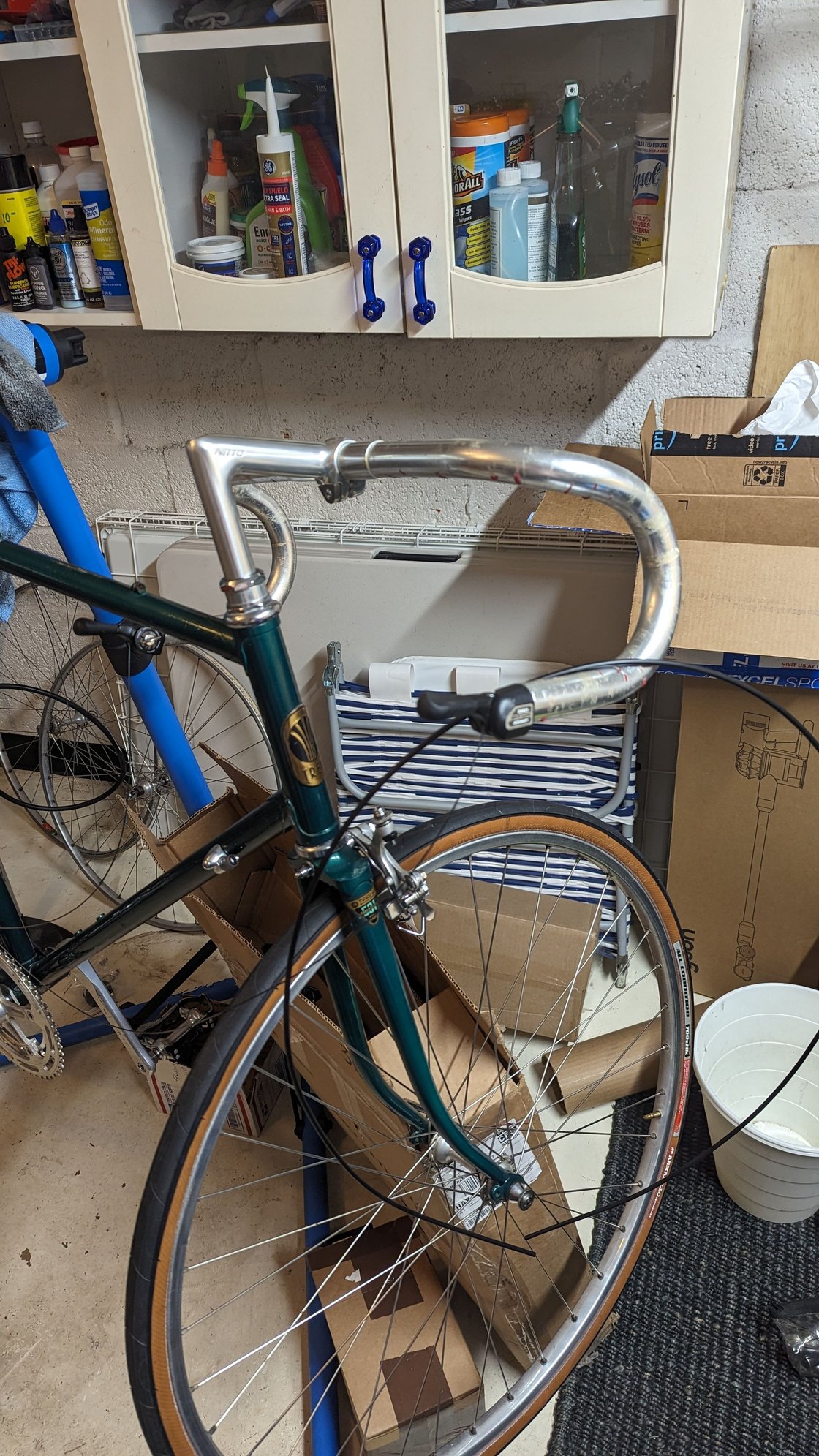

I'm trying to install Suntour barcon bar end shifters on my drop bar road bike and the Shimano road bike cable kit came with multiple types of ferrules. And more confusingly, there's 3 of one kind, two of another kind, and one of a third. None of them really sit flush in the chainstay cable stop, but it seems like they'd all work in the downtube cable stops, and all but the ones with the thin pointy part would work in the shifters themselves.
Can anyone advise me on which ferrules to use at which cable stop?
There are illustrations of the different ferrule type on the bottom of the package (the cable crimps are the outline on the far right)

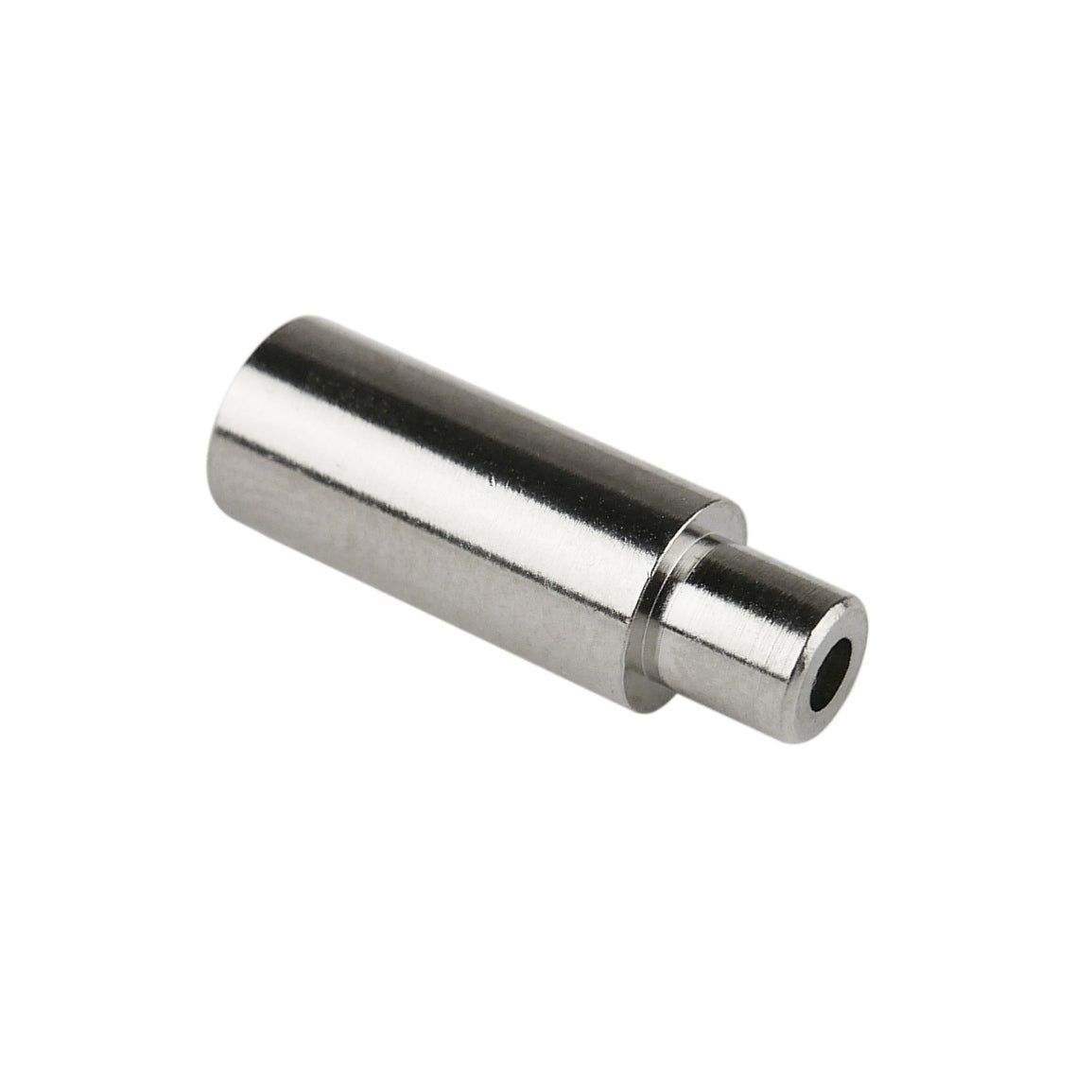

This is the kind of stepped ferrule you need for your older style chainstay stop:
