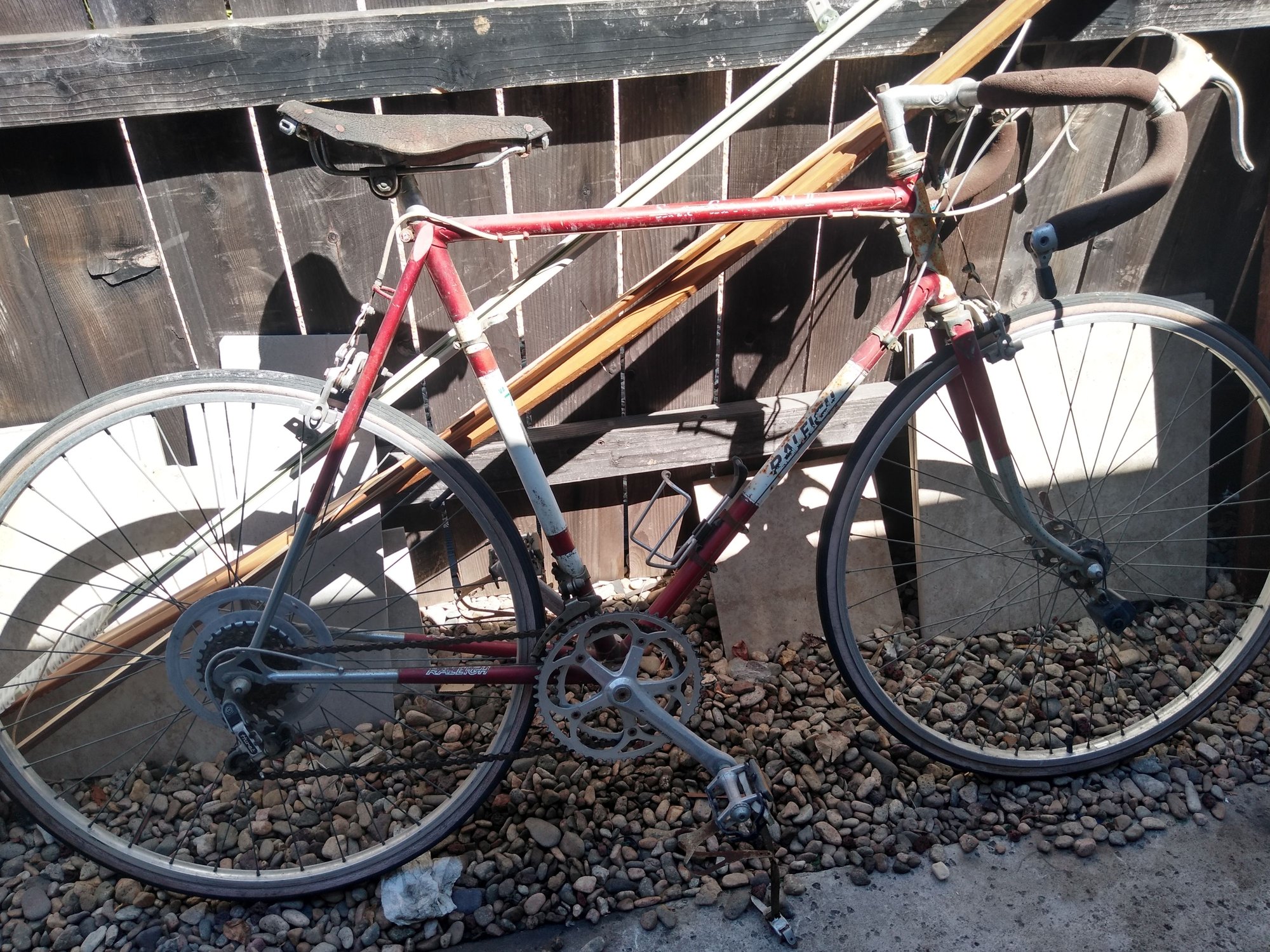

This was the two for $50 deal and the final result. Most of the original parts went on the red and white one since it was in the best shape. The stems on both were totally frozen. Other than that it was fun putting these back together. I wish they were my size.

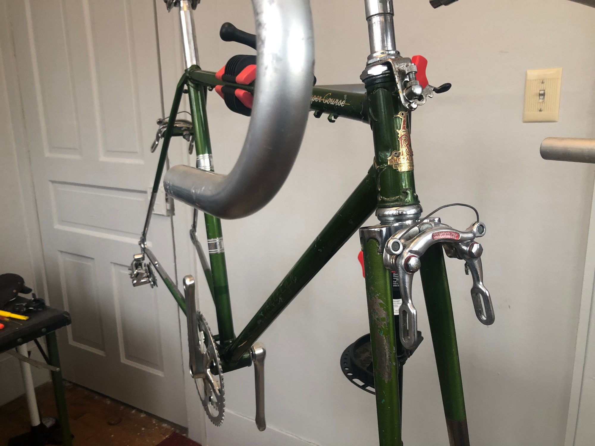

The 1971 Super Course reassembly is underway. It will soon ride again!

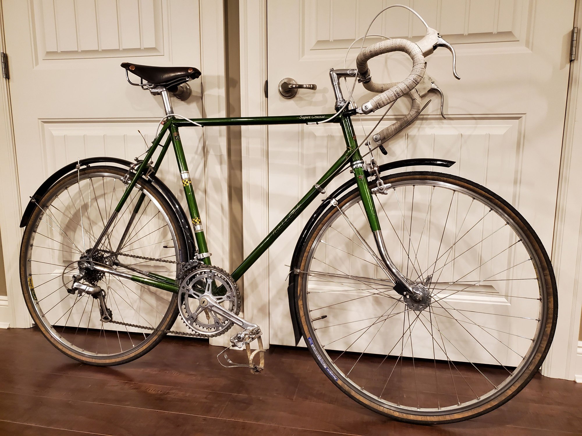

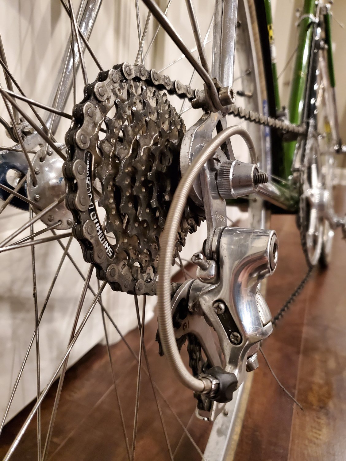

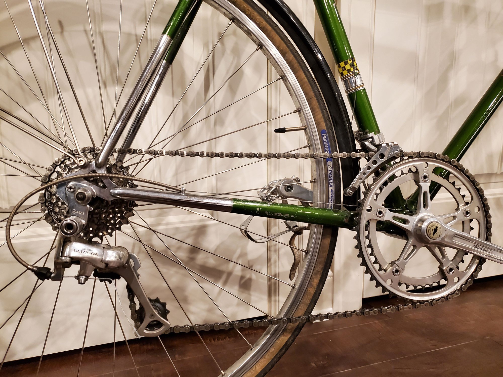

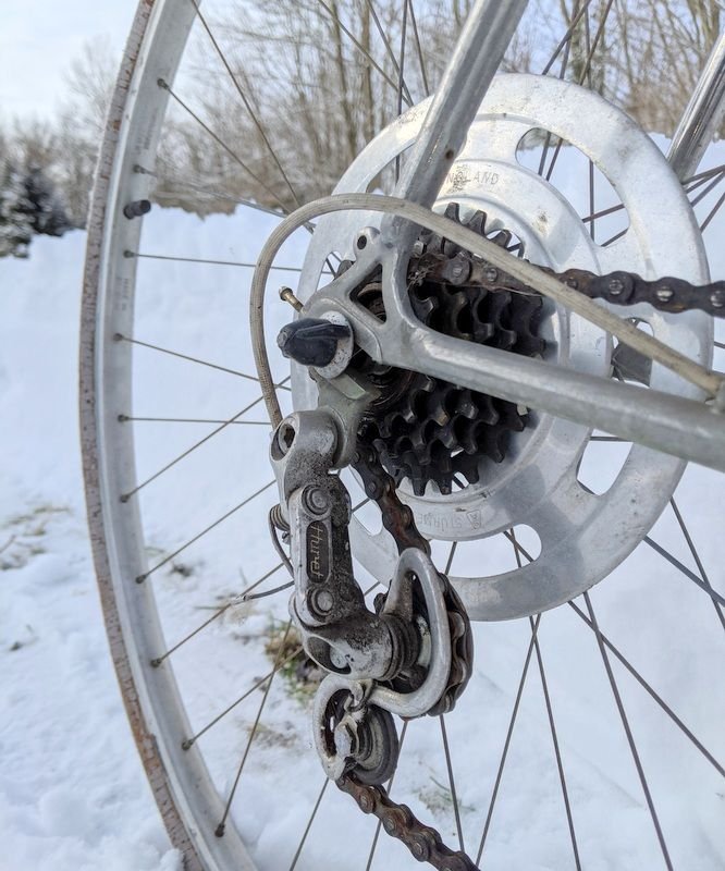

Recently rebuilt the rear wheel and the drive train a little bit. I'm so happy to ditch the freewheel and switch to 7 speed freehub. I was able to respace to 124.5mm OLD (fits just right into original 122mm). And replaced the old Suntour Vx to a modern but still looking ok Shimano Ultegra. Later on I plan to get the Velo Orange 175mm their version of Pro-5-Vis. I have 170mm Suntour Superbe at the moment, I find them way too short for me.

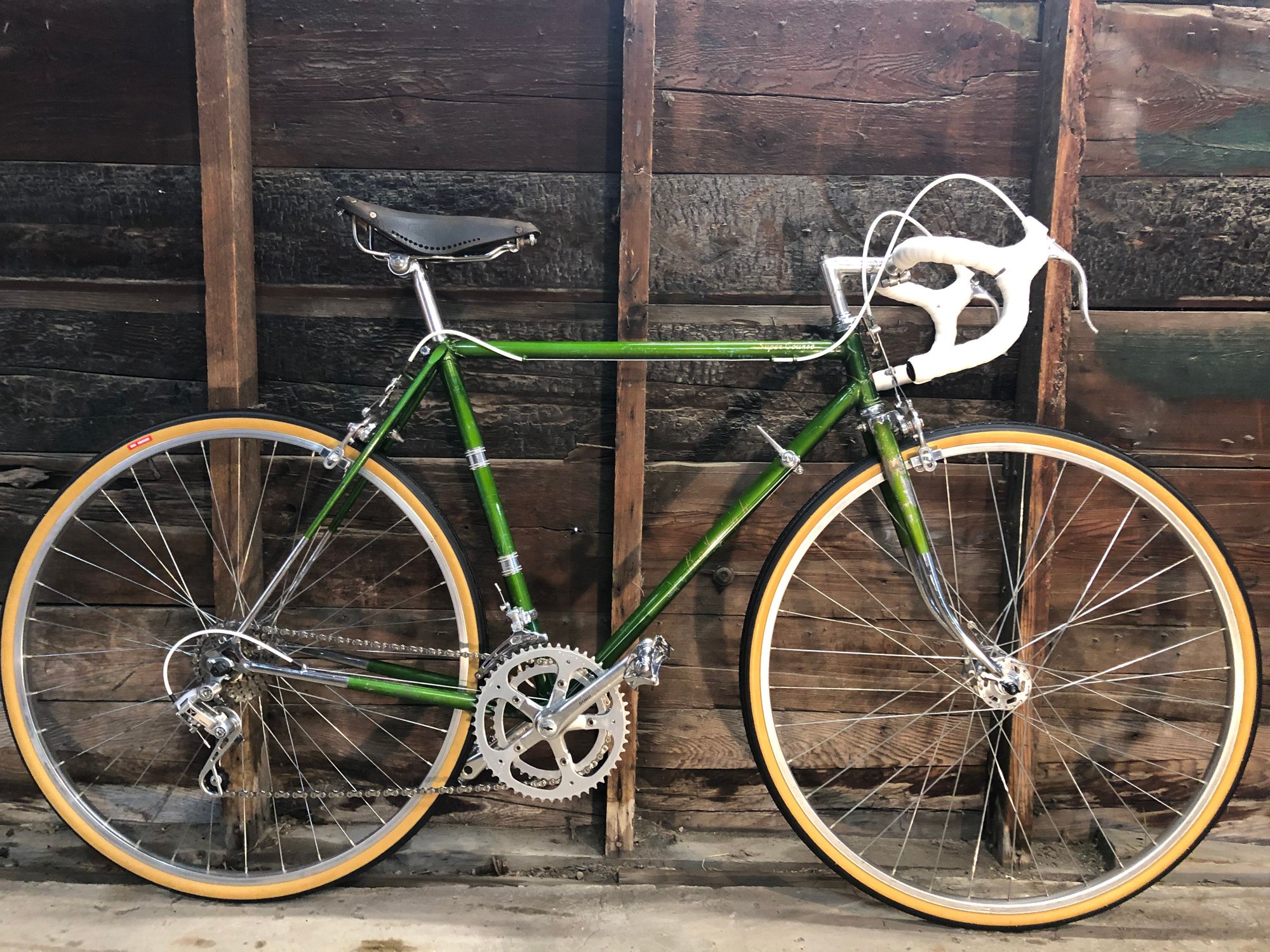

Here is the 1971 I recently finished. Put a Sakae crankset in, Road Champion bar, Shimano Deer Head RD, 14/30 suntour FW and Shimano FD.

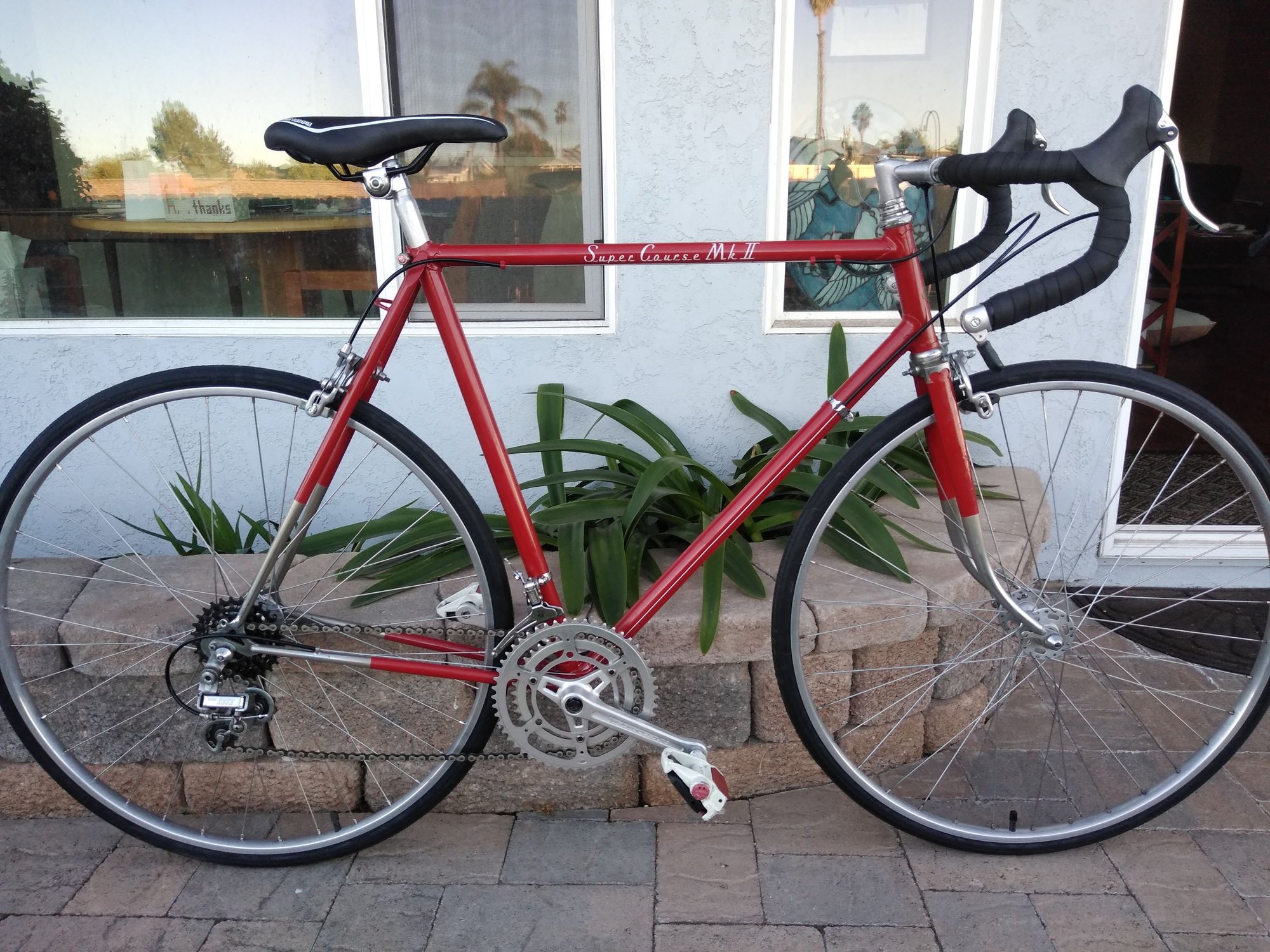

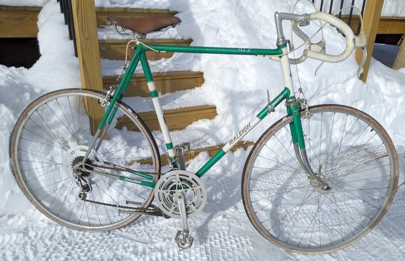

Brought home the SC MK II that WGB posted last week in the "Are you looking..." thread. Looks to be all original except for the front rim and seatpost binder bolt.
I like the forged dropouts with hanger, Stronglight crankset and the 25.5" size. Unfortunately the front Jubilee derailleur has a cracked clamp. Might have to put something Italian on there instead.

One of the rare Super Course Mk II, in that paint scheme, that had forged drop outs! When I bought mine in the Seventies, only the 25” frame sizes had forged drop outs. consider yourself lucky!

@Schreck83 you got really lucky with the dropouts, rear derailleur, crankset and hubs! Much of the bike was "upgraded" at the factory. They must have had low stock on the intended components that day.

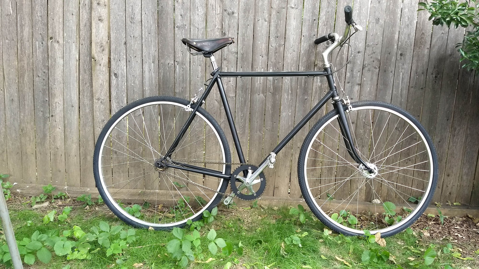

No longer a Klunker
I assembled the Supercourse I have into rideable condition for the COVID klunker challenge, but I had the parts for this intended build. I made time to complete it, and I'm close to a comfortable fit.
Better light, but seat tilt is off.
Sugino Maxy Crankset with 144 BCD. Modern TA chainring. Miche fixed cog and hub.
Mach 1 omega rim built onto a novatech hub.
Miche Primato pista/strada hub.
Polished 'GB' stem
No tape and mismatched tires at the moment.
The interesting part about this frame is that it's a 52cm seat tube with a 55cm top tube. So as long as i have enough stem extension and seatpost... it fits?

I don’t think I’ve ever seen a SuperCourse with that much fork rake or that slack of a front end?
