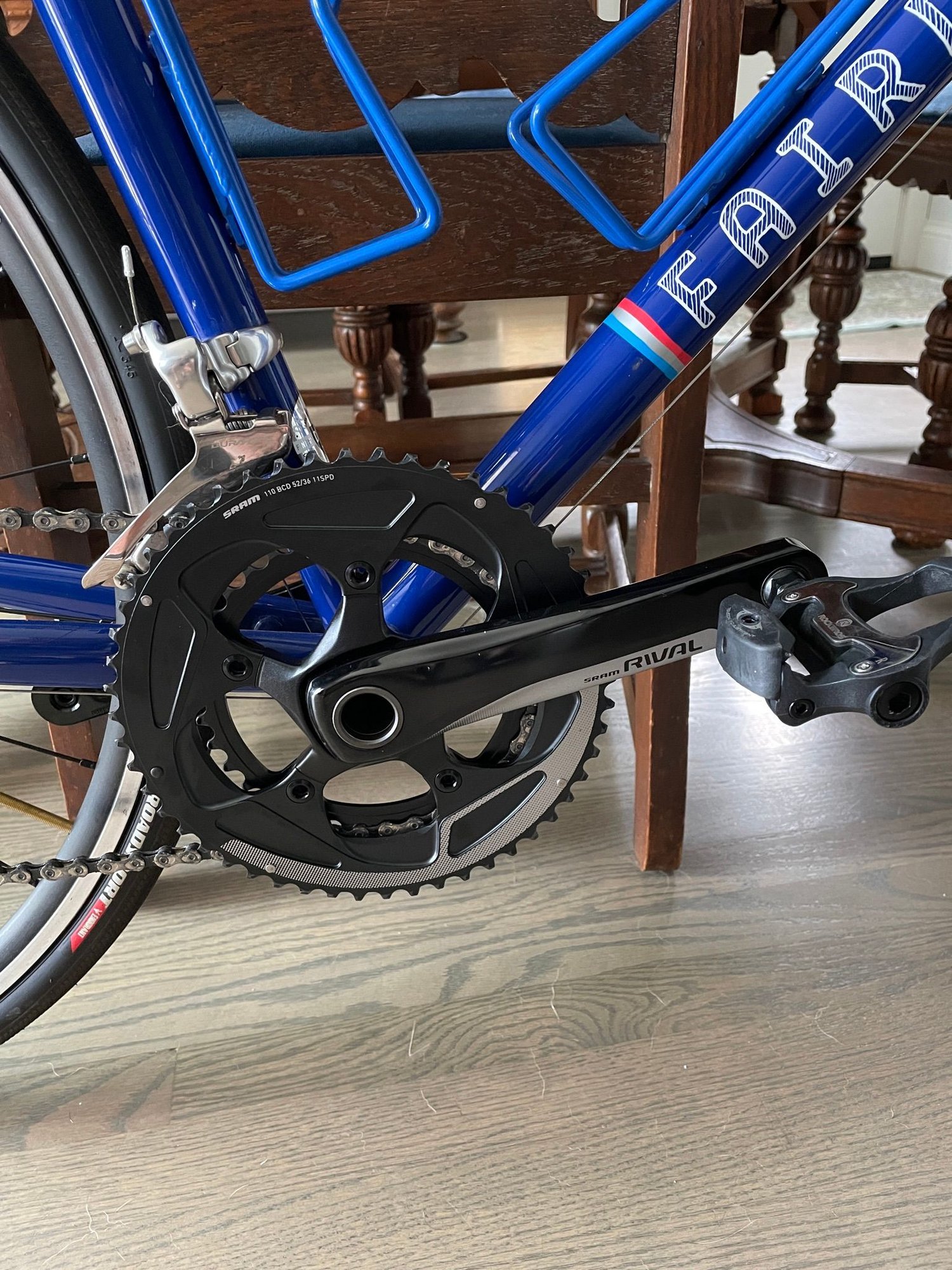

hello, so based on some suggestions I got from y'all on my first thread in Road Cycling, I ordered a set of SRAM Rival 22 cranks with 52/36 I guess that's considered "semi compact". I've been having no problems with the 53/39-11/28 coming from my vintage bikes, climbing on this is definitely a bit easier. But they're a bit beat up looking, and the 36 will help just that little bit more and I'm never going to tap out the 53/11 so I don't think losing 1 tooth on the top end is anything I'll personally ever notice. I think it was a killer deal, they were on sale for around $100 plus tax/shipping which is what I paid for my Ritchey stem at the lbs.
The other item I'm thinking about is a front derailleur, it's got a Dura-Ace on there and it works but the chain drags in some gears, I wanted to find a used Rival to match the r/d, but haven't had any luck. So I have a frame clamp and a Force 22 f/d in my cart but haven't clicked buy yet. I'm assuming this should work fine but wanted to see if anyone suggest something else. I think the whole yaw concept sounds pretty good, and it looks easy to set up.
I'm not going to spend a lot more on this bike, it's already all SRAM stuff so I just want to keep it consistent and replace as needed. I do eventually plan to get better/lighter wheels which I found a thread someone else made about replacing the Axis Sport wheelset I have, along with other threads about wheels. But these are Ok for now and the tires have a lot of tread.
