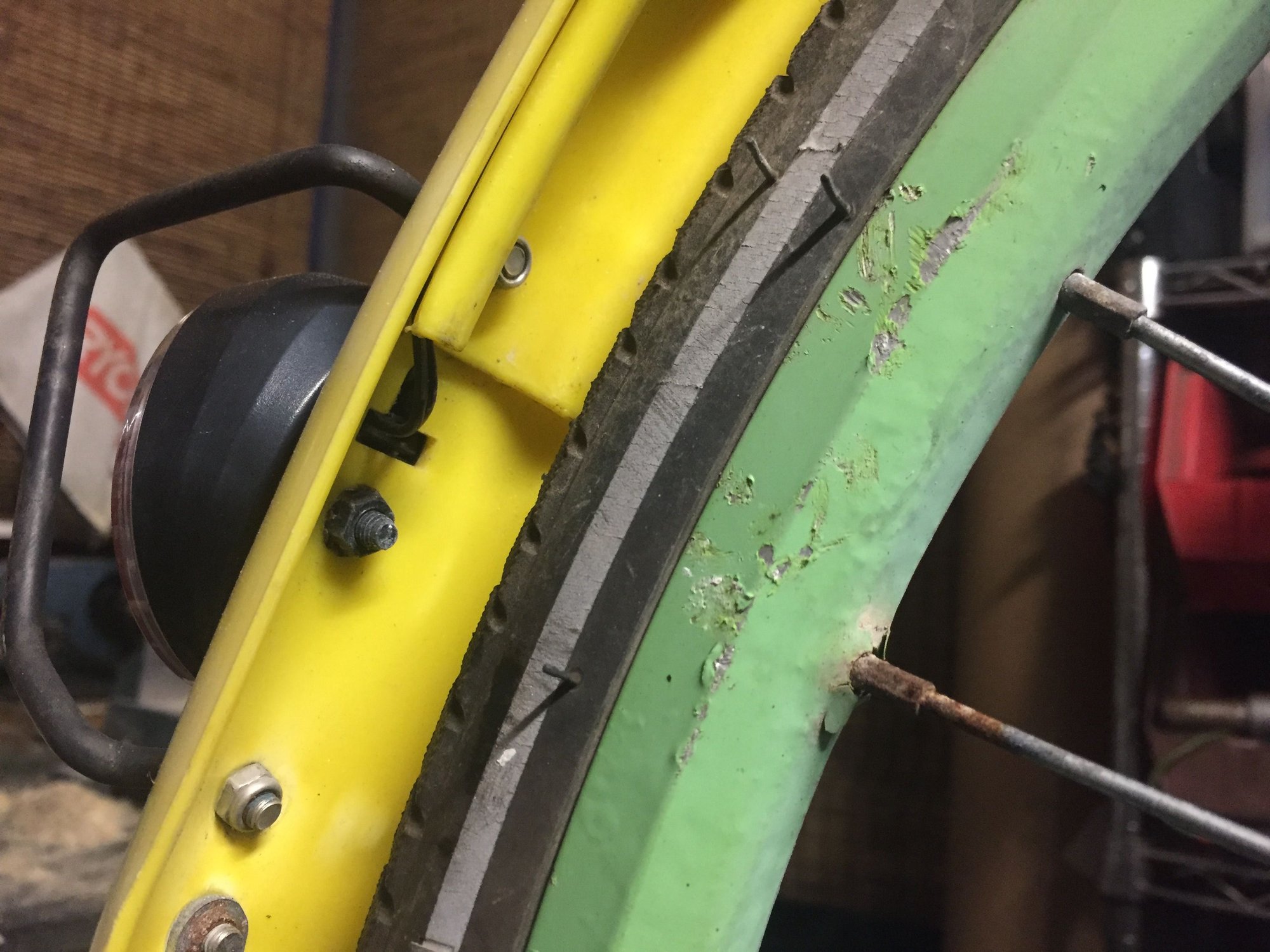

The spokes arrived two hours ago. It seems like the Sapim spoke calculator errs on the long side, as I had to grind 2mm of spoke out the tips of each spoke nipple once the wheel was built and tensioned. Not a bad thing; good to have more threads engaged than less, but I usually wind up with spokes easily 4mm shorter using other calculators.
As it sits, the wheel is about 6.5 pounds. Not a lightweight, but neither is my '51 Sports' FG Dynofour and Westrick stainless rim.
I still have to respace the rear triangle and re-align the dropouts, and the correct keyed washers arrive later this week via Amazon. I sprung for the Shimano Nexus washers, as they supposedly fit the SRAM with minimal trimming and are less prone to slippage.
There will be no need to file the dropout slots either, as - by 1980 - Raleigh had already updated the dropouts to the industry-standard 10mm from the old 8mm Sturmey standard. Like Shimano, SRAM's keyed axle flats don't align with the dropout slot, but vertically.
The factory G9 shifter is proving to be a problem, as it won't fit the North Road handlebar (and for those in the know: Yes, the bars are the narrower pattern, they're from a '75 Sports) without interfering with the curve. The G9 shares its 1:1 cable travel pull with all other SRAM trigger shifters (and brifters, if I was doing something with drops), so I can always use something like a SRAM X-7 trigger that doesn't have the built-in indicator.
Still, I don't really like trigger shifters that only actuate a single downshift per click (I prefer the old Suntour Accushift design - one deep push and you've gone across the whole range), and I wouldn't mind running a thumb shifter.
A SRAM 9-speed barcon and the Paul thumbie handlebar adapter would do the job, but it ain't cheap to get both (I also nagged the Bicycle Mechanics forum about the MicroSHIFT Dynasys-compatible 11 speed shifter). I'll probably have to give up this idea - unless someone here can hook me up with a smoking deal
I also pulled off the hideous, CPSC-mandated "coffin" rear reflector off the fender, which gives me two holes in the fender to play with:
Sure enough, sitting right above the Raleigh was the perfect inspiration for the solution, in yet another dockless machine: A LimeBike, also from my Bike Share Museum. These have a really spiffy setup, with DC wiring running all the way from their 6V front generator hubs to the integrated LED light in the back through a J channel built into the bottom of the fender:
Yes. the rim is toast.
The rear light/reflector is an innocuous enough - and circular - design. It fits well enough with the restomodded Raleigh Sports concept, and the new plan is to go with a modern 6V DC front generator hub (no Dynohubs this time) in the front anyway. The peaked fender ought to be the perfect place to hide the wires on the Raleigh.
Only problem is that getting a Lime legally is extremely difficult. I waited around for months until the County hooked me up with this one, and I'm sure that cracked rim is evidence enough that I'm waiting for another one to show up, just to restore the one for the Museum. Lime themselves are phasing bicycles out in most markets, and the infuriating thing is that they'd rather scrap these than donate them to any organization (or individual).
It'll be a bloody tall order to dig yet another LimeBike up just for it's taillight, even though I could use the rest of the parts and then some.
-Kurt

The hurricane must have USPS spooked, because all my Monday deliveries arrived today, which included the Shimano Nexus anti-rotation washers for this hub. I also went to one of the LBS'es and got some rim strip:
Spreading the frame in the stand without the BB spindle out of it was a pain in the butt, but it is happily at 135 from an ambiguous and questionably centered 113. The seatstays look funky, but the brake bridge is centered and the frame passes the alignment test. I'll fine-tune the stays for looks later.
I initially tried using my Park dropout alignment tools, but one of them wouldn't tighten down on the narrow Raleigh dropouts, believe it or not. I found it easier to eyeball the 135 by using my Campagnolo 120/126mm alignment tools. Despite this limitation, I've been finding more and more that they've been proving themselves superior to the Park alignment tools every time I pit one against the other.
I installed the wheel, but like the picture in my initial post, it didn't fill the rear fender correctly (and also rubbed the stays at the back). This is partially a manufacturing problem: Raleigh ditched the tubular brake bridge they'd used for 50 years on these for a kickstand plate on these post-1977 (Or is it post '78? Don't remember for sure) models, but they jammed the same old tubular brake bridge fender clip onto these kickstand plates.
I took out a link of chain, and the wheel pulled forward quite a bit. Though it looks better in the pictures, the hub is at the tip of the dropouts - and the wheel also looks a touch too far forward now. I've got to get a half link to get this positioned right.
On the plus side, there were no major issues installing this after respacing the frame to 135mm. It took a hell of a lot of effort to grind and file the Shimano Nexus washers to fit the SRAM axles though. What a pain.
I also took a gamble on some downtube cable clips from eBay. The seller claimed were 1", not 1-1/8", but they appeared 1-1/8" in the photos. Given that they were offset to the bottom for a single cable, I took a chance. I was right. They look good too and are fine looking alternatives to the usual cable stop.
I will probably substitute the SRAM 4mm shifter cable housing with 5mm housing for a tighter fit in these clamps.
It is a bit on the ugly side, but not much more than the Lime's light - and the over-voltage protection is a big plus. Pity that it is not long enough to cover both screw holes - unless, of course, it happens to align better on the upper hole rather than the lower one.
I usually don't drill holes in frames, but I may make an exception on this one. A hole at the bottom bracket and an unobtrusive one under the headlug for internal wiring shouldn't be too bad. Better than putting a hole in the steerer tube and stem (!)
-Kurt
