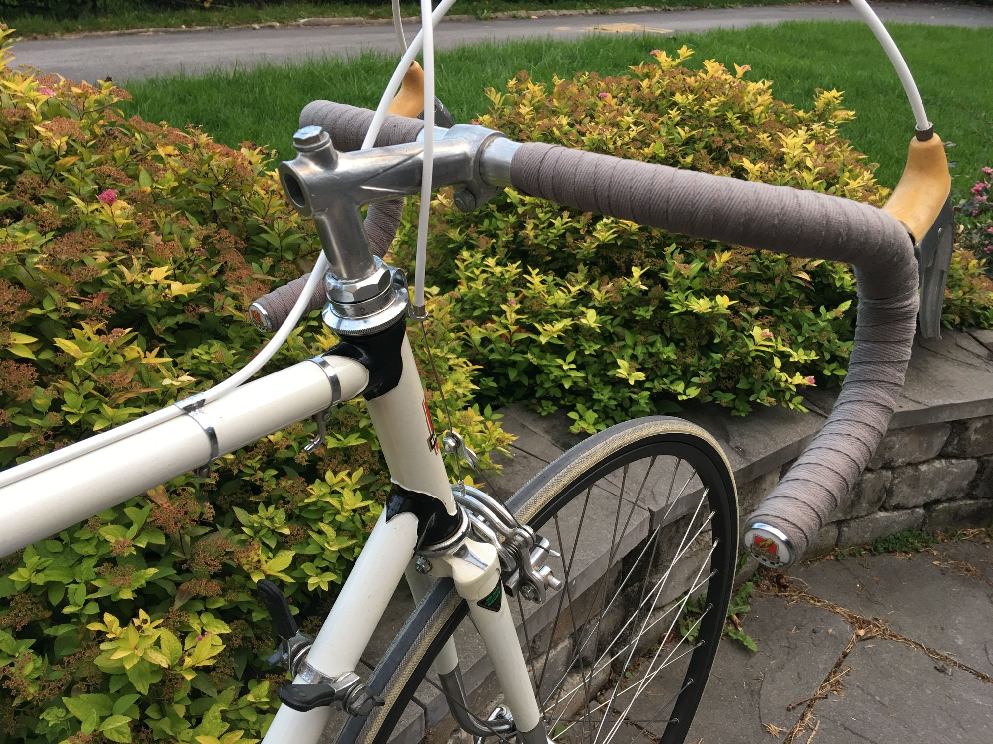

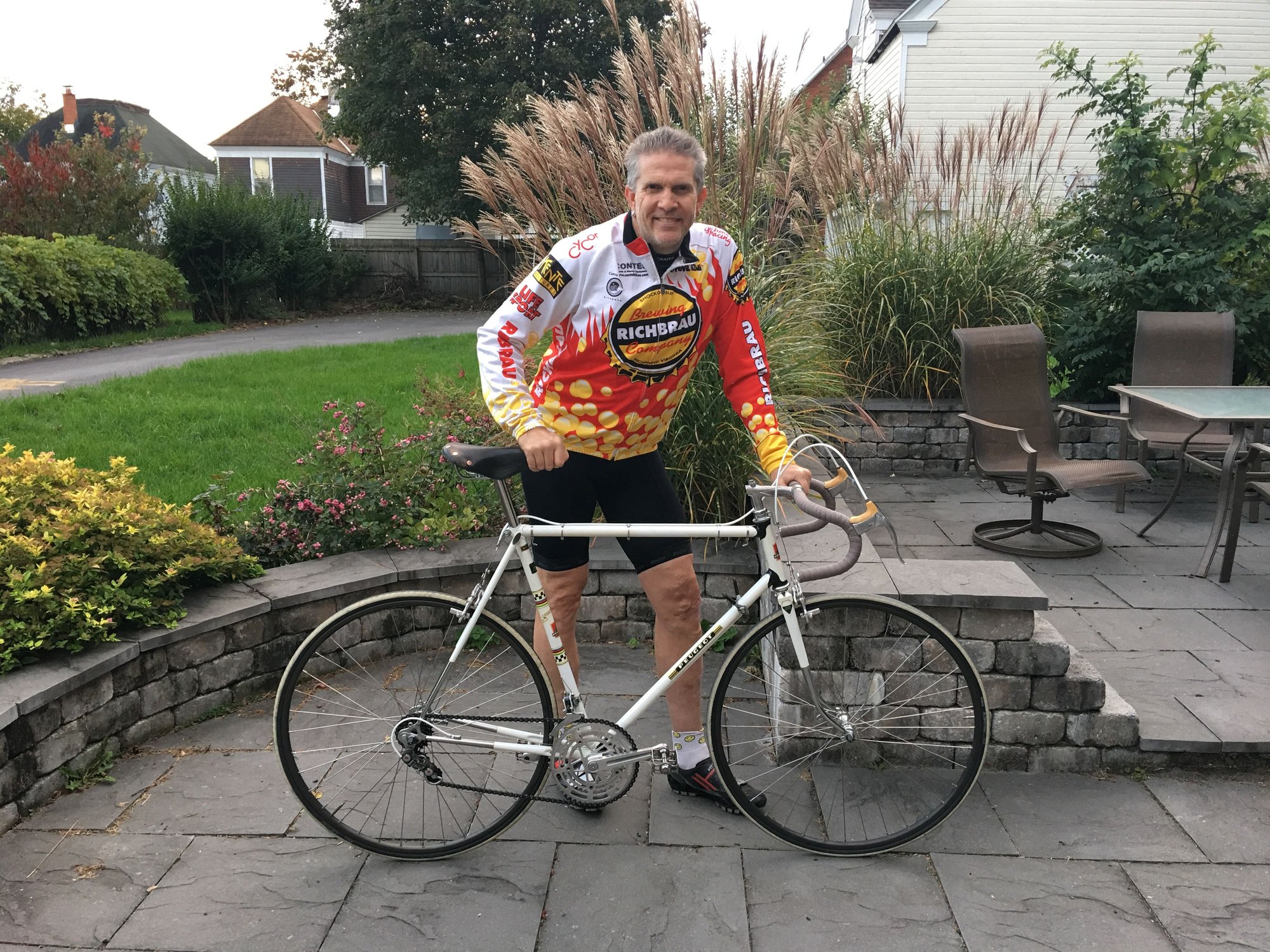

When I started posting here, I described in the Newbie thread about the little gold mine I hit. I was shopping in a dingy antique mall - more of a junk shop really, but came across a bike that really caught my attention. It was filthy - think that nasty dusty grease that collects on your range hood, or cosmoline and dirt. Well, I bought the bike anyways - for a whopping $100.00. After hours of washing and scrubbing into every nook and cranny, something marvelous appeared. I didn't really take many "before and after" photos, because what I uncovered was beyond all expectations. In the past two weeks, I have replaced all the cable housings, gotten new Newbaums cloth bar tape, and disassembled and repacked every bearing, and worked with steel wool and aluminum foil to polish up the whole bike. I replaced the Reynolds 531 stickers, and had to repair two big dings in the paint, as well as some rubs in the logos and bands. It's not a shiny, showroom restoration, because I'm going to RIDE THIS LIKE I STOLE IT! The only thing not original to the bike are the wheels, although the freewheel is - and the hubs are Maillard and the rims are Mavic. If you can see them - check out the handlebar plugs, found those on eBay for a nice finishing touch.

Dunno why those Lyotard model 36 pedals are on there, they should be model 45CA.
Wheels too late for 1972, but then you of course know that already.
OEM bar plugs would have been VELOX black rubber.
For a factory look nuts on dropout adjusters should be facing outward.
You have the nut on the cycle's ALGI seat binder mounted backwards.

I see someone already replaced the OEM 45T inner chainring with a 40. The other popular mod was to replace the 14-21 freewheel with a 14-26 or 14-28. Very nice machine, and the Brooks saddle looks to be in good shape, nicely broken in.

looks great, like a well set up PX10.
I understand the choice of pedals, for those that prefer to rice without the toe clips and straps. My feet were just too wide for the stock PX10 pedals.
I wouldn't expect the MTB shoes to grab the pedals all that well, but if a softer-soled shoe is uncomfortable, then those might be the best choice.

Well done. I hope you have enough seat post left in the tube. That is a lot of post showing.
Very nice! What did you do to bring back the shine on the brakes and cranks?

If anyone is in the market for a nearly perfect original Simplex seat post, I'd take a reasonable offer! The Simplex logo is slightly damaged (pulled away from the tack weld on one side) but can easily be fixed in place. It shines like the day it was new...

Follow-up. After a month of careful eBay surveillance, I pounced on an excellent deal - a set of wheels with Maillard Professional Team Issue high flange hubs with what I have a suspicion are Rigida rims (stickers are long gone) I also replaced the Loytard 36 pedals with a bit sleeker of a pair. The Vittoria tires I had on it were a bit dry rotted and I had a pair of Panasonic Pasela's on hand so those got changed out as well - traditional gum walls look nice.
