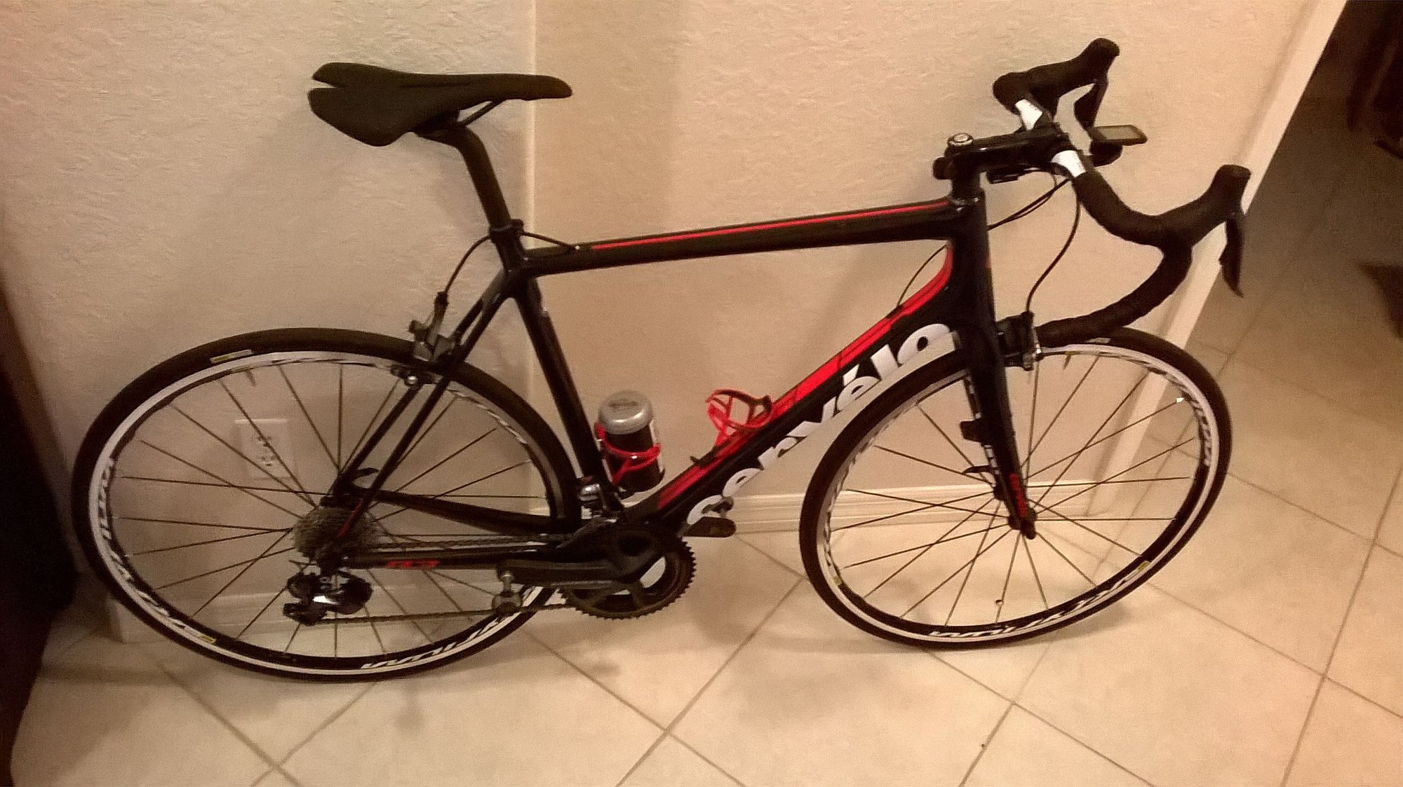

Shameless plug for my new bike below. A bit different now with longer stem and different wheelset. But brakes aren't even a consideration. Shimano dual pivot brakes are fantastic. I wanted the lightest and most aero setup which in the context of brakes also happens to be less expensive which is why I chose this bike config...but in the mountains, I would be on disc brakes.
