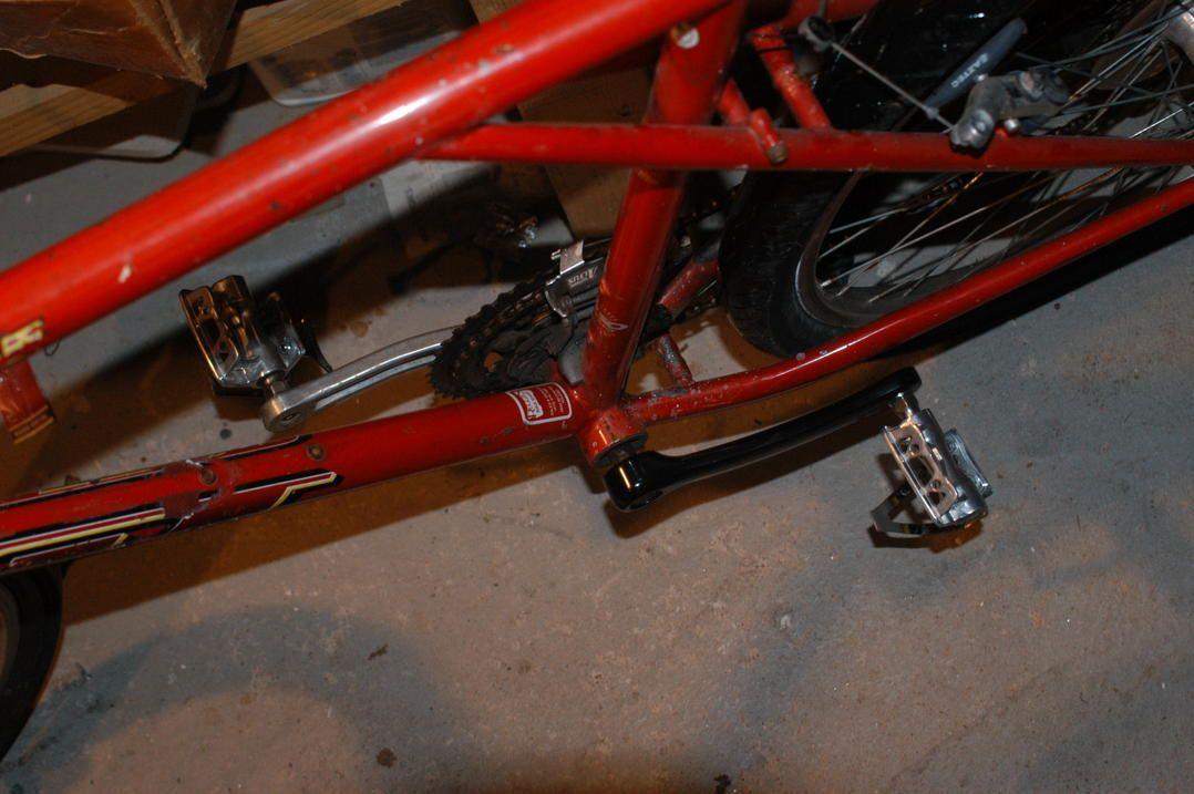

I have a 30 year old Miyata with unknown history that I'm refurbishing for my daughter. It rides fairly well. No obvious grinding or noisy drivetrain.
I will replace all cables and housings, brake pads, freewheel, crankset, chain, tires and tubes. But, I'm wondering, do I leave the hubs, headset and bottom bracket alone or should I overhaul just to be sure? They are all turning smoothly with no play.
Which leads me to a more general question - are bearing assemblies regular maintenance items? I read somewhere that wheel hubs should be overhauled annually but I don't see the purpose of that if they are running smoothly.

Thanks for the contributions everyone. My daughter is 3000 kms away and I'm sending this bike to her. She'll maintain it at a co-op and she's quite mechanically minded but she has limited space and no specialized tools. She'll also have to build the bike out of the box.
I have plenty of both (tools, space) and experience but I always replace and service on an as-needed basis. For instance, I've never opened up the headset or the bottom bracket on my 90s mountain bike that I use as my daily commuter but I've overhauled the hubs numerous times. I've frequently wondered if I was neglecting routine maintenance but like most of us, I have a million things on my plate and don't want to spend an hour doing unneeded service on my bike. I'd rather ride (or wash dishes).
However, this is my first rescue bike and I think I got pretty lucky with it. It's old but the important bits are in fine shape. I'm replacing all the cables and soft parts including tires and tubes. She wants to avoid flats so I'll be going with Schwalbe Marathons. I will leave the drivetrain (other than adjustment and cleaning) since it runs quite well right now. I'm having a new appreciation for 90s era Deore.
The hubs were indeed quite gritty and I am glad I overhauled them.
going from how gritty that looks, buy some ball bearings from a good shop and replace them.
as for the bb, in my opinion, its not worth the time to regrease the existing bearings, remove them all and install a un 24 or25 or 26 or whatever it is, that you can get at MEC for about $15. I recently did this for my wifes old beater.
this way, the bb is set for ages, will never cause your daughter any issues , and the only issue is if you have the bb tools to remove the adjustable cup side (I have these old tools still) and I used my table vise to clamp onto the other side and physically turned the whole frame to loosen the other side, none of my large adjustable wrenches fit, and the vice trick worked very easily as the leverage of the whole bike worked a treat.
while you are at it, do the headset, but be prepared for falling tiny ball bearings, do it over a cloth or something to keep track of them all. They might be in cages, but maybe not.
if you are new to all of this, be generous with grease, and maybe get a bike shop mechanic to check your adjustements of everything, for a small fee it would be worth it if you are new to this.

Hubs are done. BB replaced with cartridge. The existing cup and cones were actually in good shape and obviously serviced recently. Ran out of time to do the headset. I will take my tools out west when I visit her this winter and do them.
