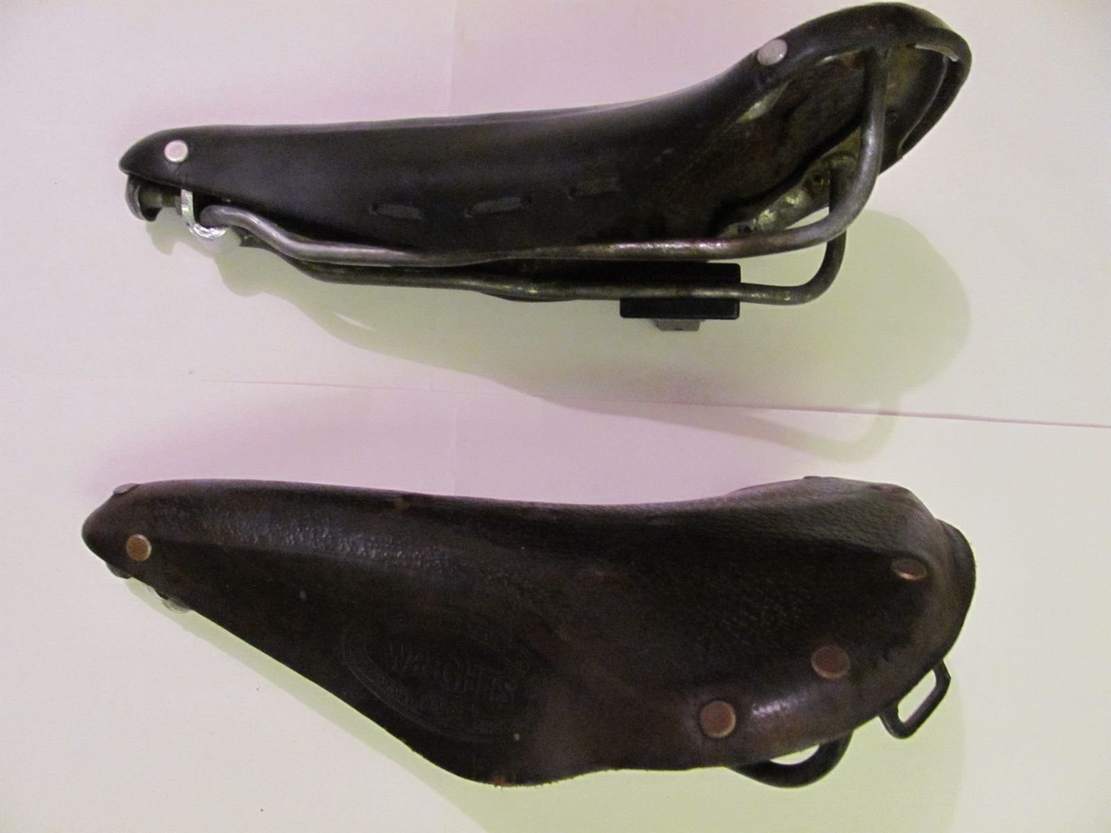

I'd try relacing the saddle if if had been laced before. I have a WRIGHTS leather saddle that I lace and some of the lacing crosses in front of the saddle clamp and some crosses behind it. I also make sure to use FLAT laces so that there is nothing very proud of the saddle to rub agaist whilst riding. The saddle at the top is the one I laced.
