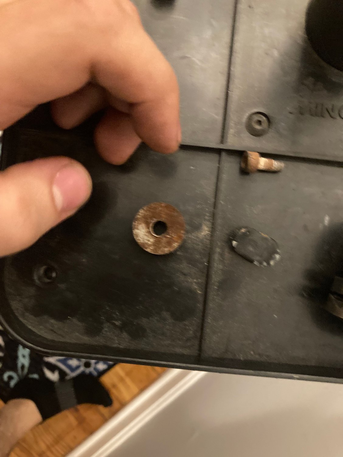

However, it sounds like the OP is relatively inexperienced with bicycle servicing, so I wonder if he didn't realize that he needed to tap the head of the expnder bolt with a hammer to drive the expander cone/wedge out of the bottom of the quill, after he loosened the expander bolt by a few turns?
After unscrewing the expander bolt, the expander cone/ wedge fell out. Went to the bicycle co-op today and the people work there recommended that I pour ammonia into it.
Darn. The expander bolt disintegrated. Do you have a picture of the rest of the bolt?
You might also try Kroil.
Problem is the Aluminum Oxide deposits are not rust...
The bolts fine. I think the expander was just a conical wedge and not angled like some others.

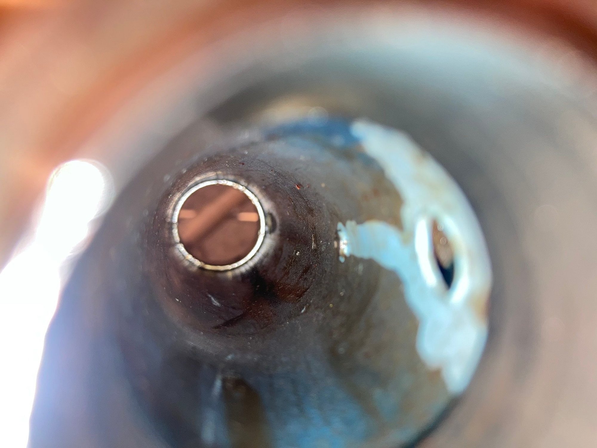

Any suggestions on cleaning the head tube and fork? Head tube is super rusted. Edit: actually its not even that rusted. Why the hell was the stem so hard to remove?

Not so much rust, just the aluminum bonding to metal, grease those stems and seat posts.
