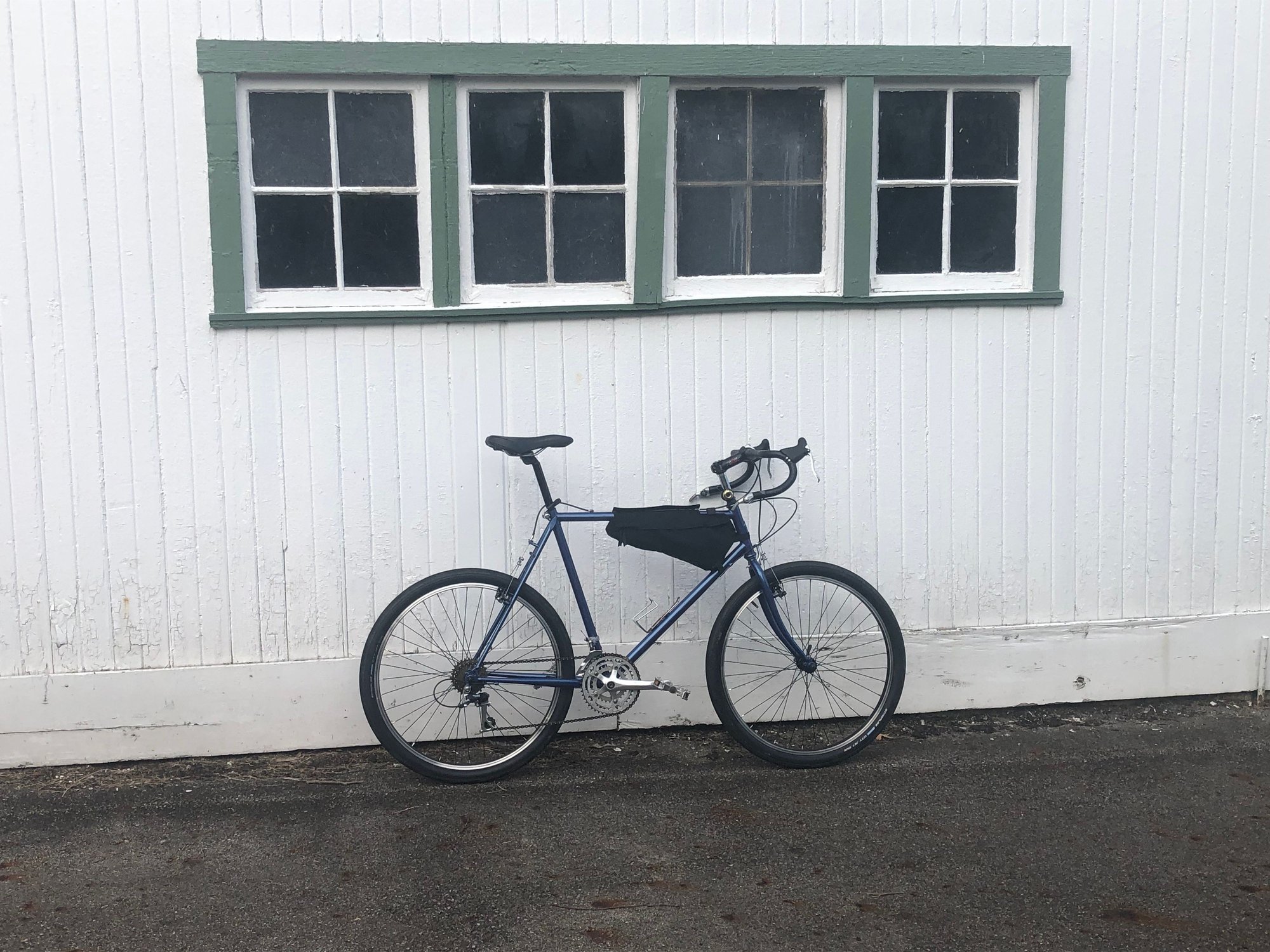

Update on this bike: added Deore 1x 32t crankset on a Hollowtech BB. Deore M6000-GS rear derailleur. 11x42 cassette.
I had to do some judicious filing to the DiaCompe Silver shifter to get the range needed to cover the 10 spd dynasys-whatchamacallit...
This derailleur shifts beautifully, though no doubt everything has gotten uglier since 1996.... and I like how light this bike is!
Before finding an 8-speed rear wheel in my stash which could take a 10-speed cassette...
Not so pretty, but really only needed to remove a few mm.
Glorious friction shifting over 10 cogs!
I'm old enough that this 11-42 cassette just looks so, so silly to me. But of course there are 50 tooth cogs out there!

Cheap imitations of TRP levers--- about $20 on the big auction site... I was trying to be cheap as I'd never tried the "drop-bar-mtb" thing before. But it's quickly becoming a favorite bike, whether for bombing around city streets careless of potholes, or ripping past guys riding dual-suspension monsters on the local (very easy) single track...
The quality of these levers seems pretty flimsy--- the plastic and rubber of the hoods feels cheap, and the aluminum of the levers has lots of rough spots from the mold-- but so far they've worked fine. Search for "road bike brake levers coffee" and you'll find what I bought. I might upgrade these someday, but like I said, so far they are giving no cause for complaint other than feeling like what they are: cheap brake levers.
Bike is sitting next to me as I type--- just rode it home from work.
