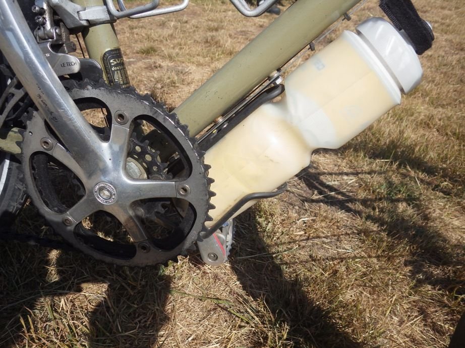

Originally Posted by azza_333
For those that are interested I have edited and added information on the mostly completed build in my initial post here.
Thanks for posting the update. Very interesting mix and well thought out. If I recall correctly you put a lot of thought into details like frame tubing diameters, etc. I recall some controversy about getting a top tube that is the same diameter as the seat tube. That looks like it worked out well.
I do not think I have ever seen rear fender mounting the way you have your stays that high and on the insides of the stays before. I can see some advantages and disadvantages from that.
I see the lower rack mounts are down low close to the dropouts. The Tubus racks should fit nice. Unfortunately a lot of titanium bikes have those rack mounts up too high and then the rack is too high, you are fortunate that the builder put them where they are.
It looks like the bottle cage mounting points under the downtube are much higher than necessary if you mount a cage there later, they are up where Surly put them on the LHT. Thus, bottle capacity was limited because the front fender gets in the way. There are adapters that can be used to lower the cage. I used to have a LHT. Before the adapters were made, I made my own so that the upper cage bolt went into the lower mounting hole. Photo of mine, below:
If I recall correctly, I had to bend the cage slightly to the left so that the chain did not hit the bottle when shifting, but I had a triple crank on that bike. If you try an adapter you might need to use a metal cage that can be bent. On my Lynskey where they put the mounts down as close to the bottom bracket as possible, they angled the mounting a bit to the left for chain clearance.
The extra length on the back side of the front fender acts as a mud flap, less dirt thrown up on the bottom bracket area and feet, I would keep it long provided that it does not get inconvenient for things like walking the bike down a set of stairs, or down off of a curb, etc.
I do not see anything to protect the chain stay from getting nicked by chain slap. Are you thinking it is unnecessary with a clutch in the derailleur? I put a strip of black electric tape on the top of the chainstay on my Lynskey, I do not have a clutch in my derailleur.
