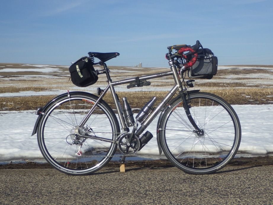

I am pretty happy with my Lynskey touring bike, model name is Backroad. It has a Surly LHT front fork with rack mounts, steel fork. When I bought the frame, the fork was not included. Lynskey wanted over $300 for the fork, but I had a LHT fork in the basement that had the correct rake and axle to crown length, so I decided to use that fork. That is why it has rim brakes on front, disc on rear. But the Backroad can only take 37mm tires if you are running fenders.
First photo with panniers, second photo without racks.
I built it up myself, so the parts were what I wanted.
But a titanium touring bike is not cost effective, a titanium frame instead of a steel frame only knocks a few pounds off the total weight, and when you are piling on a bunch of camping gear, a few pounds of weight savings is not noticed. So, only think about a titanium touring bike if you really want it, not because it will make your load lighter as it won't.

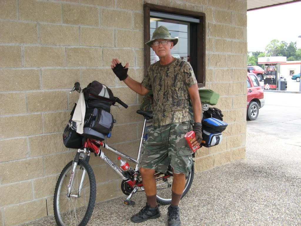

I set up all my families' touring bikes (6) with mountain bike gearing. We all run triples, 44/32/22 cranks, 11-34 cassette, mtn. rear derailleur, and road front derailleur, which will still works well with road brake/shift levers. It takes a shorter bottom bracket to maintain an 45-46 mm chainline. Using the same parts on all the bikes makes things simple for maintenance and parts. Most shops can do that for you.
A couple of my touring bikes.
The LHT was built from the frame up.

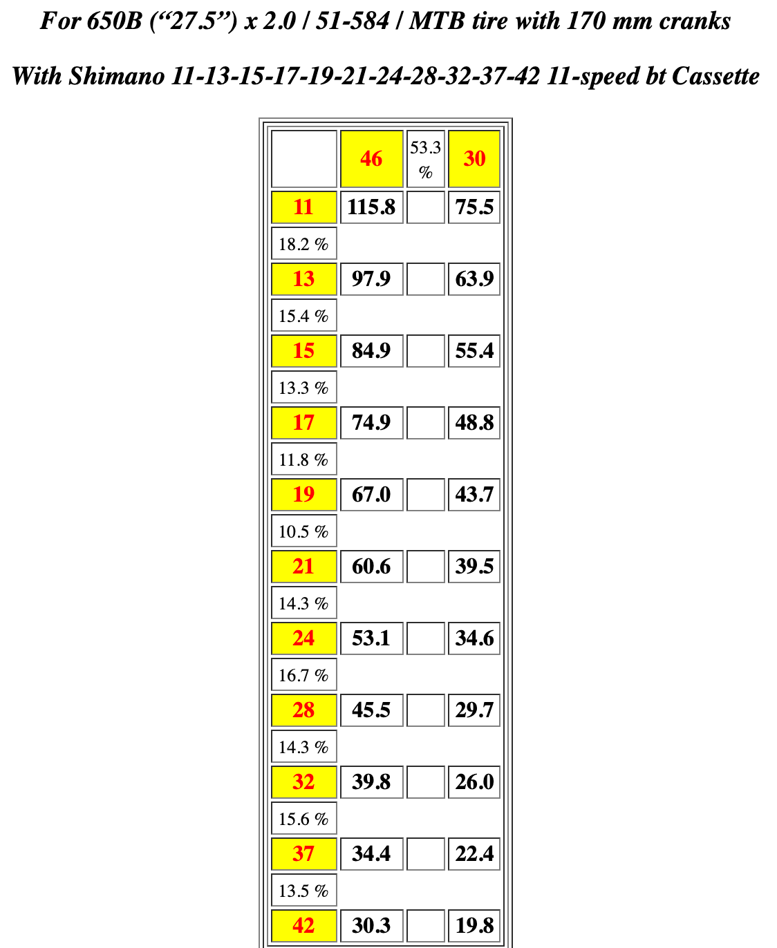

A few caveats, the setup Doug has used, and me too but with Gevenalle shifters, is with 9 speed stuff. When you get into 10 speed, you start getting into tricky details of shifters and rear derailleurs that won't work with each other, mountain bike stuff is "dynasis" (could be mispelled) and road brifter shifters have different cable pull.
there are numerous brifter setups that can use large cassettes and some doubles, but what you want to look into about gearing is using charts that calculate "gear inches" of your gearing, specifically your low gear.
but until you 've ridden with a bunch of stuff/ weight on the bike, in hills, all day , it's really hard for you to get an idea of what low gearing you need.
The old recommended range of 20-100 gear inches is still a pretty good one and covers a good range of touring and touring weights.
Off road or places where you'll encounter steeper hills and looser surfaces, it's nicer to have lower gearing.
and to repeat again, there's never a downside to low gearing, you might only need your lowest gear a few times a day, but when you do, it's great and you save your legs. Especially if you're having an off day (you will) or hungry and you hit the always present surprise steep bit here and there.
Sheldon brown gear calculator
html gear calculator
both good and allow you to play with numbers, here are two examples of bikes of mine

The tricross is a cross bike with a triple, but I have 28mm tires and a closer cassette, and it's low is nearly 26 gear inches.
Any touring with any weight is tricky when hitting steep hills, but I don't tour on it like this.
The other bike with the mtb gearing was set up specifically for touring in mountainy terrain in other countries, with unknown surfaces and steeper gradients expected, and carrying more weight than usual due to circumstances of the trip, so it's really low nearly 17 gear inch low got used often, and boy was I glad to have it.
When not needed, you don't and shift up, easy peasy.
hope this gives an idea of what to look for in gearing setups.

One thing with touring is accepting that your average speed is just going be less. Even working your ass off, a heavier bike is just going to be slower, and you have to balance out all day effort so that you're ok the next day, and next day and next day.
Sometimes you have a kickass day, a crapload of climbing lets say, so its nice to have a shorter day or a rest day afterwards.
but this is all stuff you have to figure out what works for your body, and of course, we toughen up and get stronger during a trip, but you still have to ride and listen to your body.
oh, re going fast downhill and gearing, i spin that 111 g.i. bike out at about 70kph.
My expeditiony 103 g.i. bike to a bit over 50kph, but have ridden both bikes to 80kph, so going fast isn't about tall gearing, and anyway it's really damn rare that you can hold even 30kph on a touring bike, so spinning out at 50/55k is fine for me. Plus panniers and stuff are a real drag aero wise anyway, and our average speeds are pretty slothlike pretty much in the big scheme of things.
hope you find some good info on recent combos. The dude on pathlesspedalled does lots of gear hacking with recent stuff, so you should be able to find reliable sources for possible options.

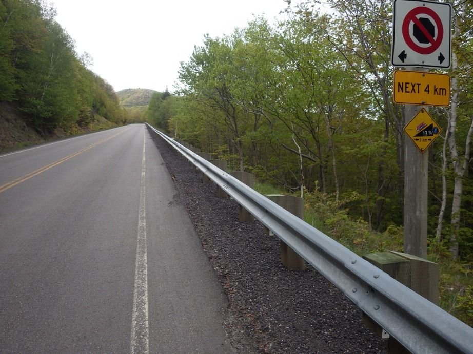

Originally Posted by sdimattia View Post
Thanks! This gives me an excellent idea of what to look for in gearing. I recently climbed an 11% 0.4mile hill on my road bike with 29 GI naked (as in just me on the bike, with clothes). Had to stop once but didn't have to get off. The gearing I'm looking at now ranges from 115-20 GI with a GRX 2x drivetrain, 105 brifters and TRP brakes. I'd love to get it down to 99-17 GI with a 36/26t crankset but finding the corresponding front mech is a bit of a pain.
I have three touring bikes, light, medium and heavy.
Light touring, the Lynskey (photos previously posted in post 31) gearing ranges from 20.7 to 115.5 gear inches with 700c 37mm wide tires.
Medium touring, 19.3 to 107.7 gear inches with 26 inch tires, 50mm wide.
Heavy touring (bike in last photo in post 12 above) range from 16.2 to 85.2 gear inches with 26 inch 57mm wide tires. This lowest gear gives me 3.5 mph with a cadence of 72.
I think a good range for what you are planning is around 20 to a bit over over 100 gear inches. Lower is nice but on paved roads you will probably not need it much lower than 20 inches.
I pushed my bike up this 13 percent grade hill (photo below), lower gearing would not have helped because if I was going fast enough that I could have maintained directional stability, my heart rate monitor would have told me to stop. Pushing allowed me to maintain a sustainable speed up the hill.
My point is that having a gear low enough for any hill you ever will encounter is impractical, I have seen 20 plus percent grade hills. You have to draw the line somewhere.
