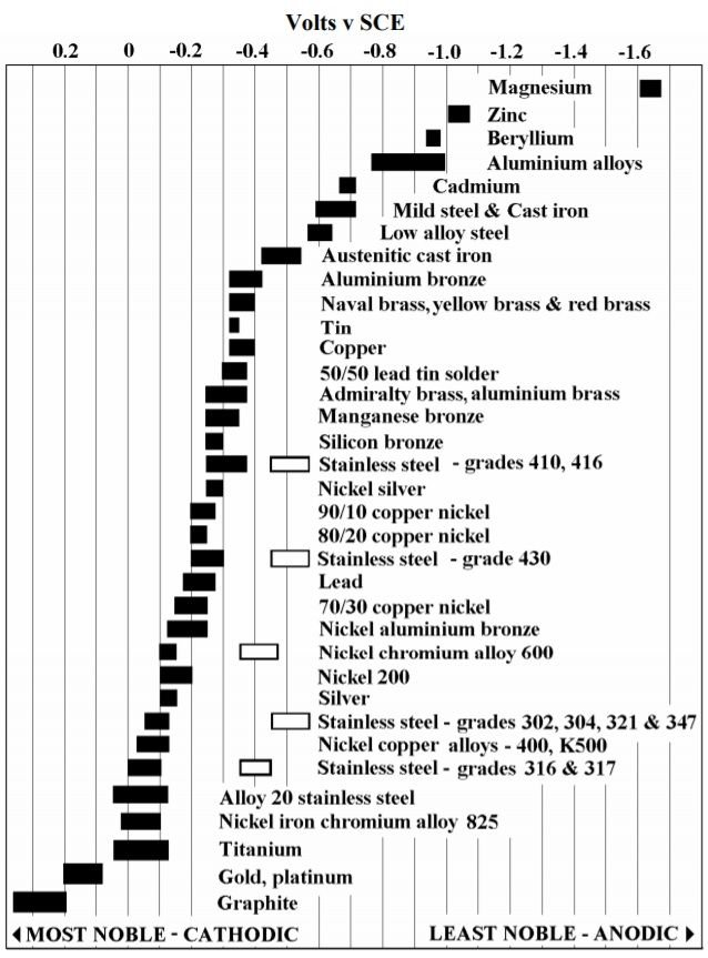

...to some extent, the answer to this depends on what you are trying to keep from seizing. But yeah, most of them work for regular old aluminum/steel contact and steel/ steel contact. Carbon anything is a special case. There're a number of charts that take the electrolytic potential of various metals into account, and from there you can figure out specific anti-seize compounds to use in your application.
I think I have small jars of both a zinc/copper sacrificial metals compound, and a nickel compound. AS stated, bicycles are not especially demanding, if you store them someplace dry and don't live near the ocean, or ride them through a lot of road salt.
