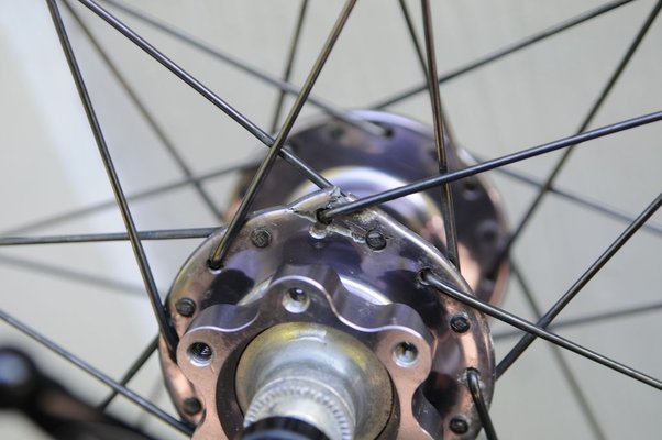

The wheels should be trued. The shop will probably do it for $20 a wheel. You can inspect the hub flange to check for cracks that look like this:
If there are any cracks the wheel is done for. If not it could possibly last you another lifetime. I don't think anyone has the crystal ball to predict which hub is going to develop cracks down the line.
