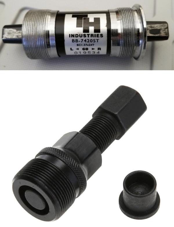

I got a used MKII Birdy Light, whose 56T single chainring I'd like to replace with a double eg. 56/40T.
Using a Litepro derailleur and a B-series Litepro clamp, it look like the fork won't move far enough outward to reach the outer ring.
According to the datasheet, the bottom bracket is a 113mm, TH BB-7420ST.
On a Birdy (Light), has someone successfully replaced the single chainring with a double? What derailleur did you use, and did you have to replace the bottom bracket for a wider one?
Thank you.
Edit: Another issue is the seat slides down unless I tighten the clamp really hard. Cleaning the seatpost + inside with a clean rag and degreaser didn't help much. Any idea what I could try?
Edit: One more question: Using this crank puller, I was unable to remove the crank, with the Birdy Light supposedly using a 68x113mm TH Industries BB-7420ST bottom bracket.
Should I try harder, or are there different pullers to match different square taper bottom bracket axles?
Edit: It was the right puller. The cranck was just super tight.

I am unsure about birdy 2 but birdy 3 uses a 68mm BSA threaded bottom bracket.... So either can use a 24mm crank or a 30mm crank depending on the crank spindle.
There are a few options available out there.

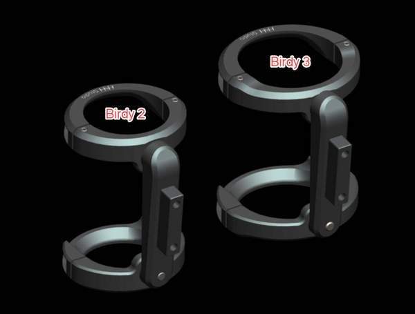

I have a Birdy III with the H&H front block adapter and it didn't move down, even with the front bag heavily loaded.
Yes, please publish the video if you can or send me a message with a link to i if you cannot.
For the easy wheel, when i wrote "Brompton easy wheel" I was meaning any easy wheel for Brompton with a M6 bolt, not made/sold by Brompton.
The only limitation is if you want to put a rear pannier on the rear rack and have relatively big feet. Then to avoid to hit the pannier with the heels, you need to put the pannier very much to the rear, and easy wheels above 45mm in diameter do not allow to put the pannier at the rear end of the rear expedition rack.

For a small wheel bike and without a bigger than usual chainring (60 or 65t that anyway isn't compatible with the new Birdy chain tensionner) a cassette with a smaller cog of 9t or 10t is needed (as mounted by R&M on the Birdy Touring).
The classic Shimano/SRAM freewheel body is limited to 11t as smallest cog.
R&M was using the now discontinued Shimano Capreo 9s system and is now using a Sunrace system (R&M use the 10s one, there is also a 11s)..
Another option that I have chosen is to use the SRAM XDR system.
Dropbox is not safe, can you post it somewhere else ?
For the Birdy disc front hub, there are indeed some options, also Hubsmith and Ridea but not easy to really buy.

I can buy Ridea and Hubsmith Birdy disc front hub separately.
For the rear hub, as said the problem is to have a freewheel body that accepts a smaller cog with less than 11t. Besides Sunrace and its proprietary body derived from the old Shimano Capreo, there are now SRAM with XD/XDR, Shimano Microspline and Campagnolo N3W
Thanks for the video.
But this Brompton front block adapter for Birdy is not the H&H adapter that I have, see picture below from the website of Bikegang (mine is slightly different from the first picture, it is like the second 3D drawing).
As you can see, the angle of the Brompton block is very different on the two adapters, on your it is much more vertical.
When I turn the fork, it also slightly pushes on the clip but not enough to unlock it and it only happen at a big fork angle that never happens when riding.

#1571
Join Date: Jul 2021
Posts: 3
Hey, so recently got my hands on a Birdy MK1. It was cheap and the frame still looks solid no cracks etc, just the seller neglected to tell me the free-hub is dead.
Turns out it is very hard to get a hold of 18inch wheels here in the UK. And finding a replacement hub seems next to impossible (20 year old part out of production I assume)
The Hub in question is a Shimano Nexave FH-T300 Silent Clutch
7 speed cassettes
Not sure what to do here, seems like a simple fix if you know what your doing. Any suggestions would be much appreciated. Can I use a different hub without wheel rebuild, any where I can find parts etc
Thanks
7 speed cassettes
Thanks

You've therefore got several options: (i) Attempt to service the freehub. (ii) Rebuild the back wheel yourself while keeping the 7 speed gearing;(iii) Rebuild the back wheel using a hub that accommodates a wider range cassette; (iv) Contact a business with known skills in maintaining bikes, preferably Birdys to see if they will do the work. A couple of possibilities are:
