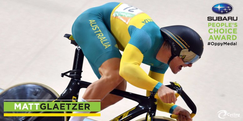

I'd like to know how aero it is going that low. My guess is that once the chest/stomach are below horizontal, you start to produce more drag. You almost never see an aero position go that low, at least not now with wind tunnel testing readily available.
That's what I'm curious about, but I also figure that the national team wouldn't do it if it didn't work, as both the men and women seem to have the same kind of position

Glaetzer's position is crazy - I love it. With him, for whatever reason, it looks natural and not strained. Something about how he rides makes him particularly look like an animal, a predator, something big and feline and scary.
The thing about what works for pros - especially sprinters - is that they have go with what feels right. It's sort of a vague item that aligns with them needing a position in which they can put out maximum power. It might not be "optimized" for w/cda, but then again an "optimized" position might fail to take into account other sub-optimal conditions.
Frequently, I think it's not a great idea to look at the pros for too much inspiration. They're freaks. We're mortals. And they don't always follow or trust science.

Glaetzer: 6ft 3in (190cm), CHIN ON DA STEM:
I find it hard to believe that he's pedaling "full circles". I'd imagine that his hips are so closed that his hip flexors are completely shut off. At that point, it's simply HULK MASH.

Ribbed seatposts? For pleasure or aero?

Maybe the the ribs are set 1cm apart or less and the seatpost wedge in the frame actually lock into those ribs with custom seatpost made for each athlete so one of the ribs is at the proper seat height for the respective athlete. Could even have different seatpost for the kilo that is ribbed appropriately. I am just guessing a reasoning of it.

That'd be my guess, too.
I always wondered if the BT Edge and Ultra had seatpost issues under bigger riders.
The top of that post has silver bits which is different from the normal seatpost.

BTW, this pic illustrates how low he gets compared to others:

I like the idea, sort of like an adjustable height drop hitch.
If it were custom, or even just S,M,L,XL sizes, you would only have to rib the bottom portion that makes contact with the wedge bolts. Maybe to smooth dirty airflow around the seat post? Sort of like a rear diffuser on a sports car.

Post isn't the standard BT part either and the ribs are there for aero reasons. One of the guys in my cycling club is a sports engineer and we were talking about the seats over coffee. Best I could describe them as they're a little like pivotal seats and posts underneath from bmx if anyone is familiar with them, and I believe the tops are printed.
In theory they shouldn't be able to tilt under load but I'll see if I can find out any more info about them.
Edit: engineer for our state squad, but the national team overlaps in areas here because the national team is based here.
