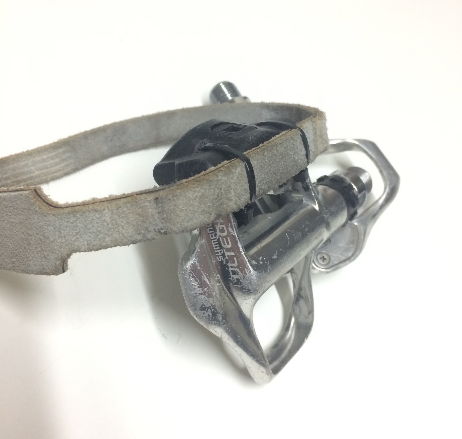

Here's a slightly different way to mount straps to SPD-SL's with zip ties.
I stole these from my road bike while my VP track pedals are getting warranty replaced (bearings went sloppy). I attached straps the usual way, but found the straps too far forward for my liking, not really being behind the ball of the foot at all. To get them back a bit, I heated up an old broken spoke red hot and bored holes either side of the spring mechanism on the clasp, then cleaned it up and ran my zip ties there. Boom, straps placed much more nicely.

I'm pretty sure that this is the first time I've seen this mod done. The brits put screwholes into the same locations for their strap bracket, but this is really slick!

Here are Hoy's* pedals. Note the bolts go through the same area where you cut out. These bolts bear load as the strap would tug on the bolts during max effort and seemed to work well enough for the British. Baby Puke, your system wouldn't put any load in this area. All your holes do is make a place for the straps to go through and affix the strap against the bottom of the plastic clamp that grabs the cleat.
Another difference is that the British system would force the cleat closed when the strap was tugged. Your system does not. It simply pulls the pedal up from the bottom which is arguably better.
The only concern is if the system allows the strap to slide and shift from being under the bottom to being across the back. I guess testing would let you know if that's happening.
So, if this passes testing, it would be awesome. And it would work for current generation SPD-SL pedals as well (I checked mine).

Yeah, I do prefer where the strap is for Hoy's pedal, which is emulated by the VP-73T pedal (rear strap position in this photo)
Unfortunately, the VP bearings don't seem great, and mine got loose after just a couple of months use primarily on the trainer, and are not serviceable- same construction as LOOK Keo from what I gather. Hoping warranty replacements hold up better, as I really like just the single strap in the back.
There is a possibility of the strap slipping on the SPD-SL as I have it, will know after I can do some real efforts with it, but I think it will probably be ok as it's pretty much a static load on the strap, and shouldn't be moving around much.
