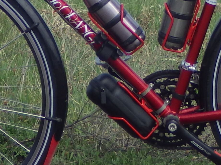

Or the Zefal container on my light touring bike, below. The top of the tool container unscrews, so it is much more waterproof than the above one.

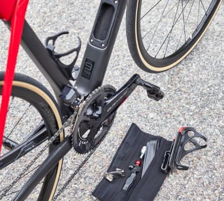

A few carbon fiber framed bikes have internal storage compartments that will fit a small tool roll. Trek Domane:
