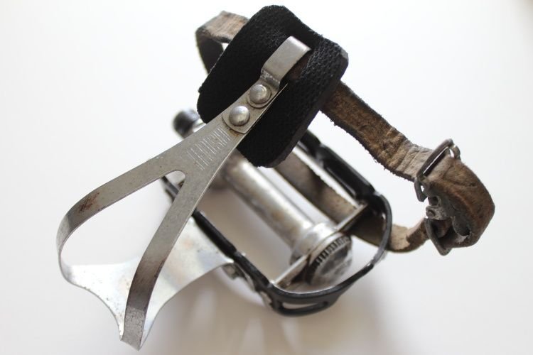

I have some pedals, I think they're KKT and they have the Christophe cages and leather straps.
I want to know how great a disadvantage I would put myself at to use these with cycling shoes or sneakers rather than SPD pedals and modest SPD shoes.

I realize clips and straps are pretty much relegated to vintage status at this point -- hence posting this question in the vintage section here. I'm also asking from a perspective of touring -- perhaps 70 to 100 mile days but not at race pace. In this context, 80 seconds over 25 miles is irrelevant. The comfort factor is easy to test and that's really the only way to get the answer that's meaningful. What's not so obvious is how much energy is wasted and to what degree muscle engagement is hindered by pedaling with sneakers in clips, and how much cycling shoes in clips ameliorates those losses.
