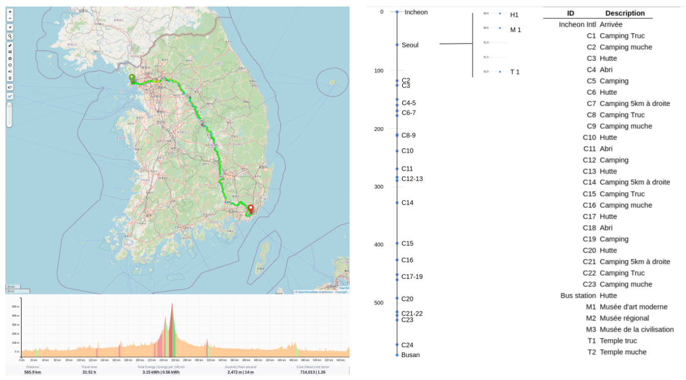

I dug up two unfinished plans from 2 years ago, when we we contemplating riding from Incheon to Busan. It may convey the idea.
On the left, a screen capture from bRouter. On the right, a topological rendering generated with Google Sheet. These simplified maps could be used as an index for a more comprehensive travel kit - click on a segment to go to the larger scale and perhaps additional material.
[WRT keeping a Kindle screen on -- quick test suggests that preventing sleep drains the battery at the rate of 10% / day, vs probable 1% / day for a sleeping device, so I think I'll stick to hitting the power button and wait 2 seconds for the display to come on. Onyx BOOX allow you to customize the lockscreen. Too bad the Kindle doesn't.
brputer map on the left, topological (draft) on the right.

The hack on a Kindle Paperwhite is to create a PDF with the picture you want to display on the cover, convert it to a MOBI book and set the Kindle to use the book cover as lockscreen. (Which means that the PDF much be the active book).
So while it can be done, a much simpler alternative is to turn the kindle and go to whatever content you want to access.
