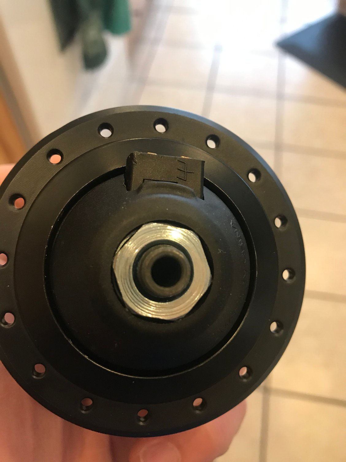

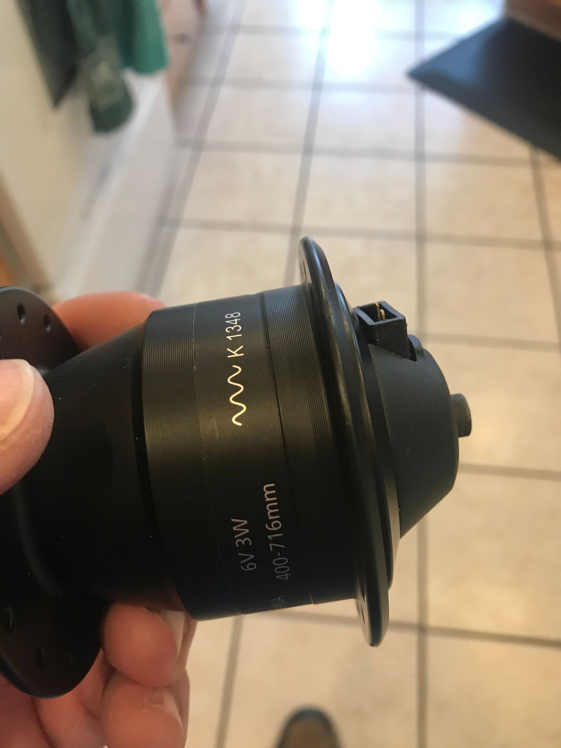

So the hubs just came in, and as a bare hub it looks to be a decent piece of kit. I bought both a 32 hole and a 36 hole version because they were so cheap. Here are some pics :
Panasonic BEP-NRH002BE
~~~K 1348 Rotation direction
6V 3W, 400-716mm I assume this means rim diameter?
Ground or earth is the right terminal
But tightening torque 20Nm ~25 Nm
Instruction “manual” pg. 1
Instruction “manual” pg. 2
Just need to get it laced up into a rim and settle on a light unit.
