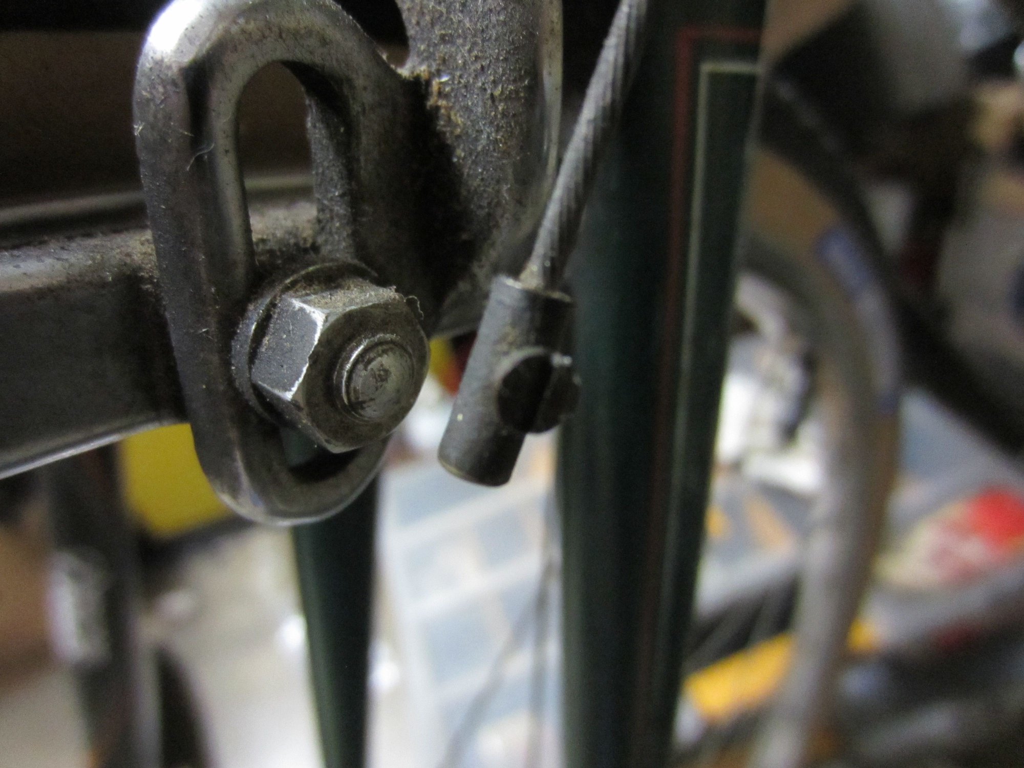

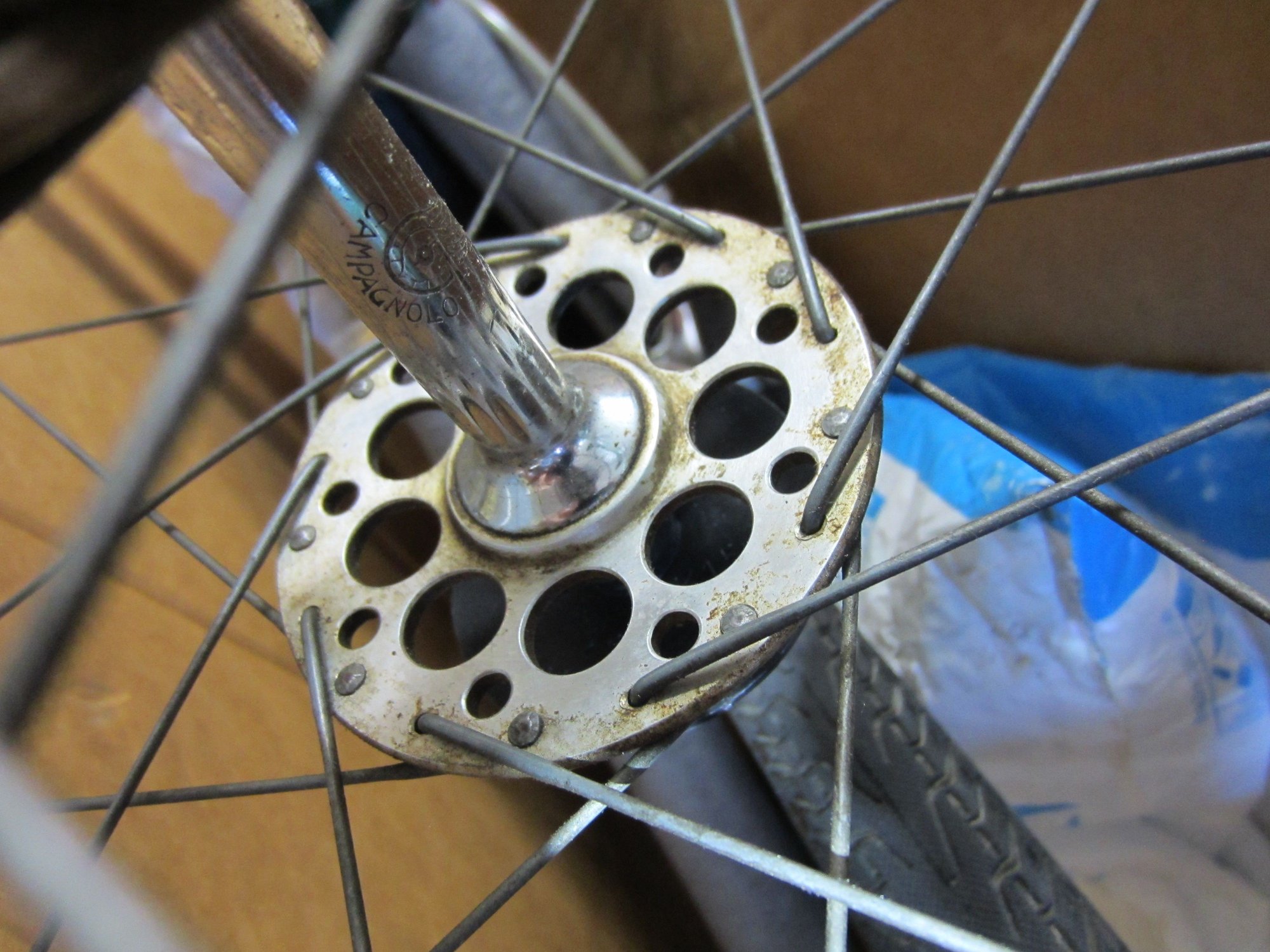

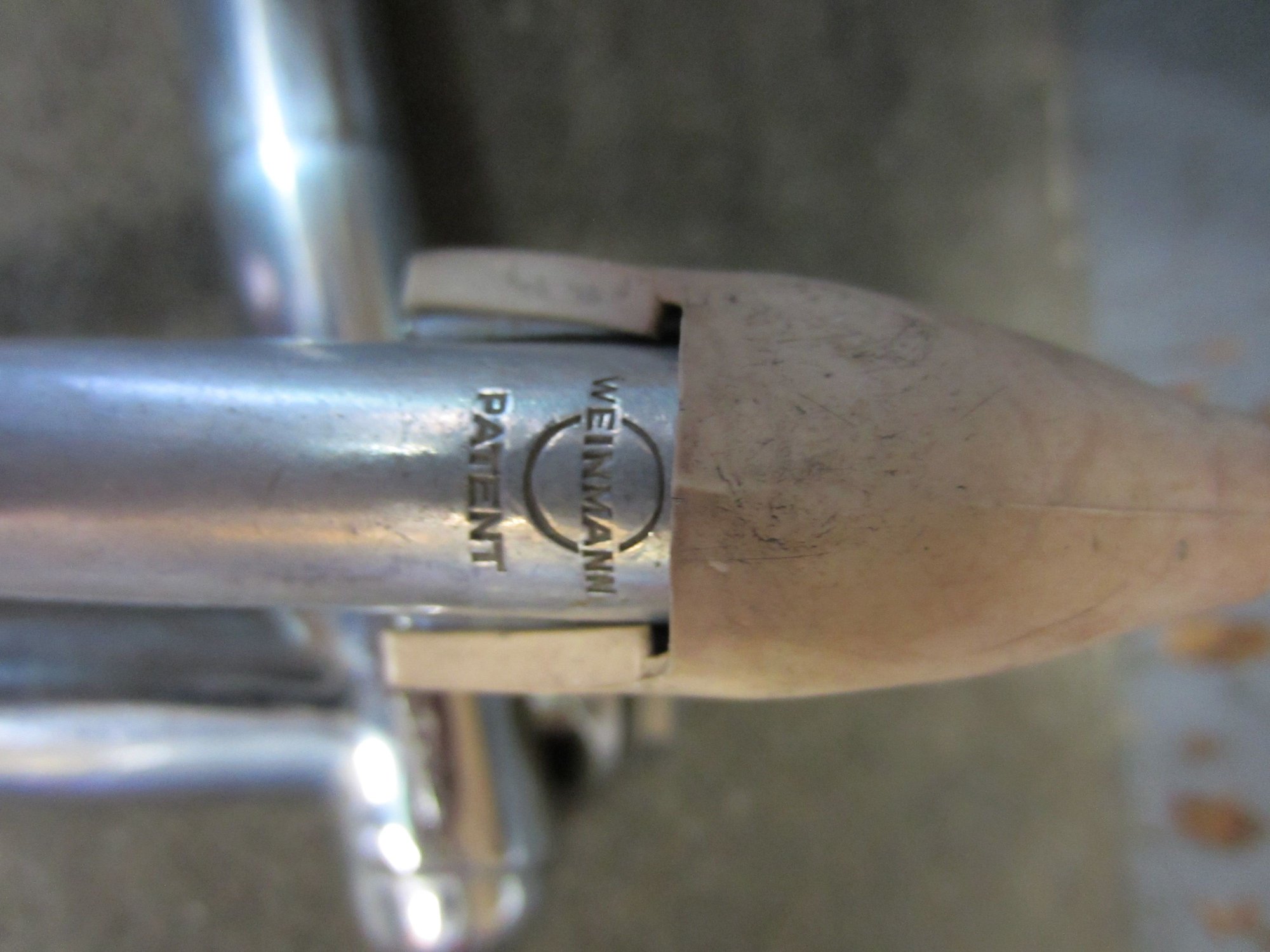

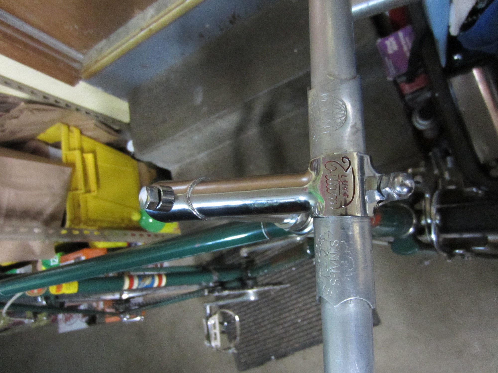

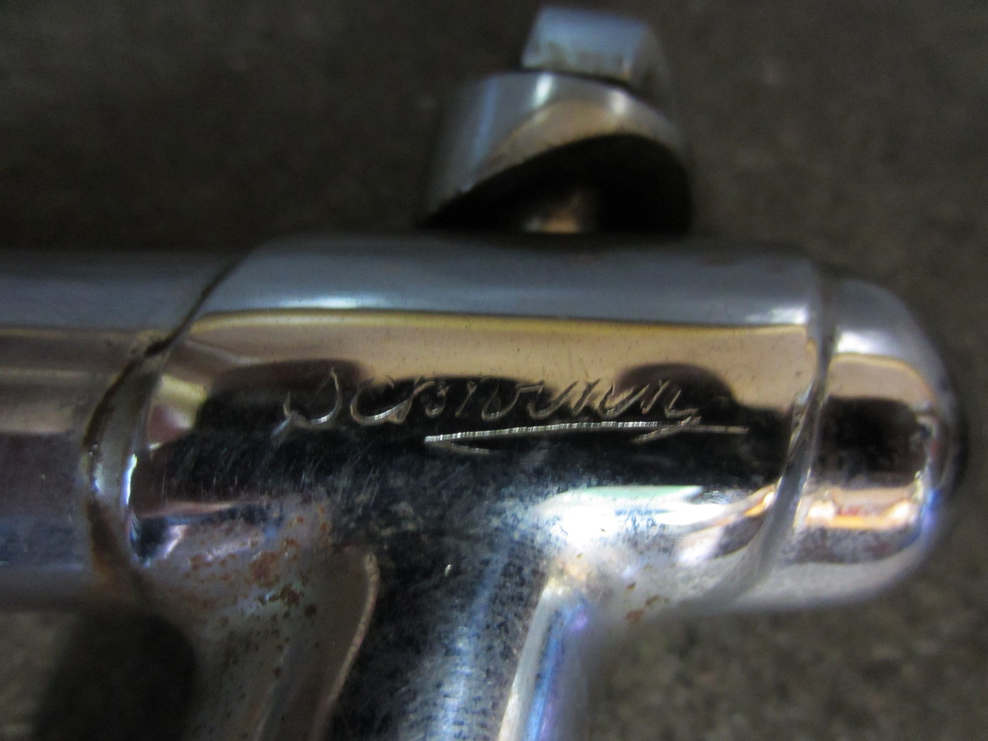

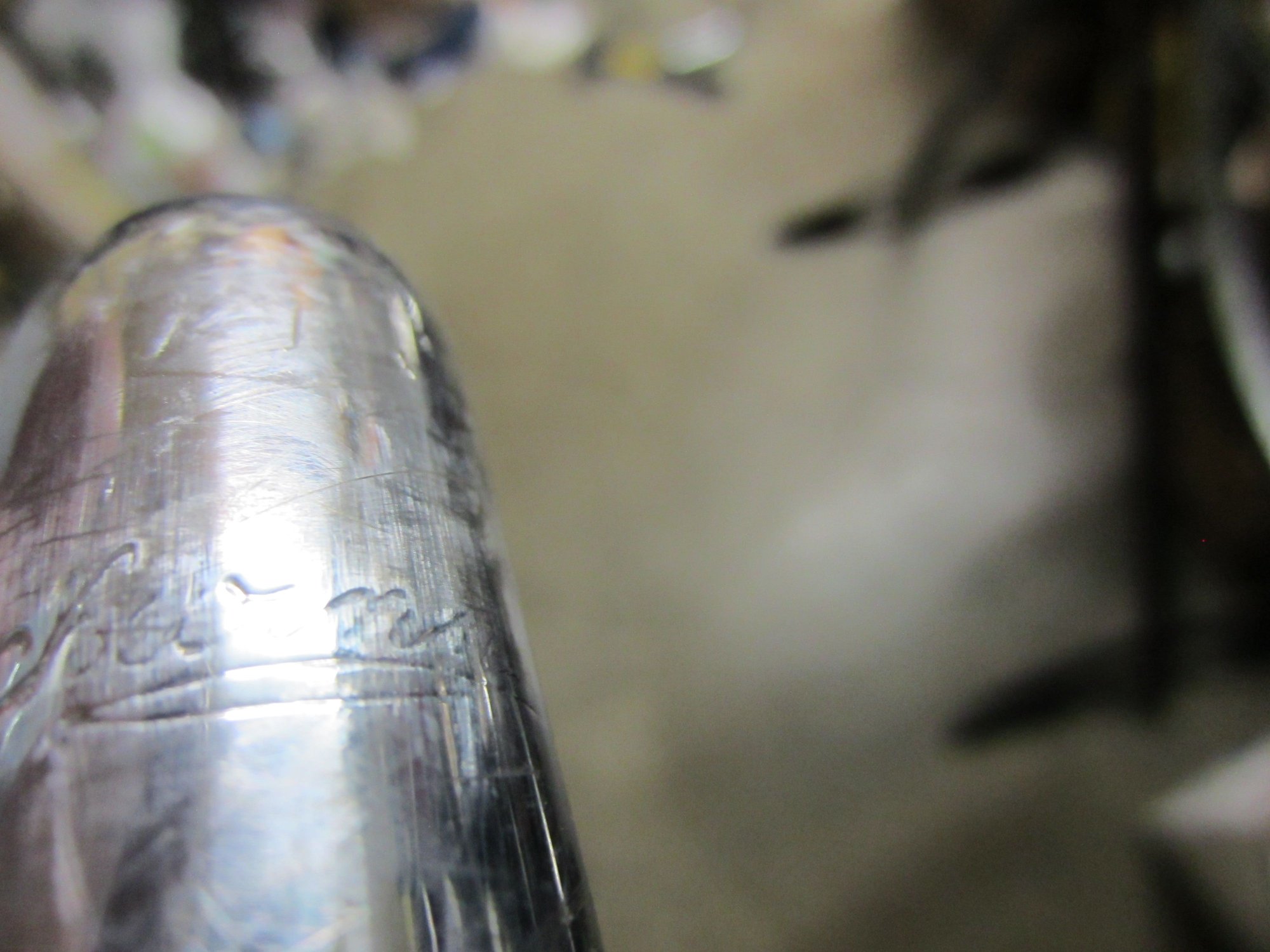

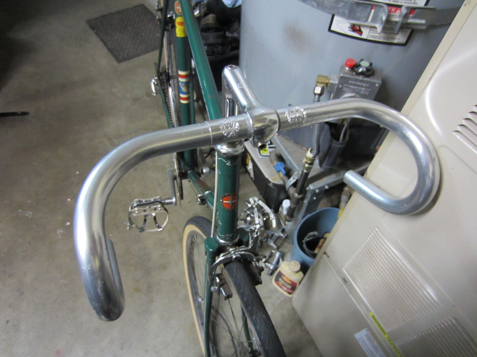

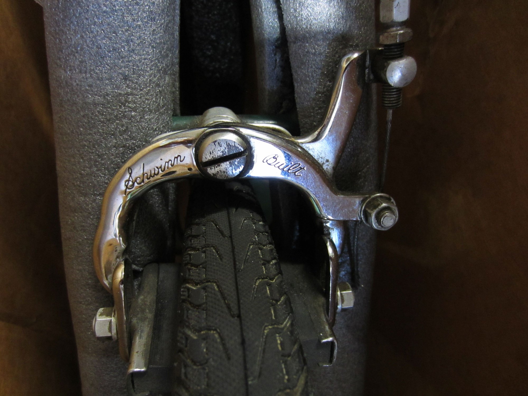

So locknuts verify hubs are period correct, love the set screw cable end, couple of pics are later bar options, last pic is seatpost, stem knuckle is upturned for more upright position. The PO said the bike had been setup with rando bars and turkey levers for the PO before him to be more upright but he had the bars below the stem, go figure, fugly and all it is really growing on me.

Please be careful with your minimum insertions. It would be a huge shame to crack the seat lug or bulge the steer tube at this point. I realize you are just setting things to see what they look like at this point. I've seen enough frames ruined by this to be a bit paranoid, so sorry in advance if i'm overstating the obvious. For that bike, it would be worth getting a custom stem made if you need more extension.

Bars below the stem is the way I've seen those set up, but that's probably because they are usually on track bikes. I remember a really tall guy had a bike with one of those in my hometown. Can't recall which way it went.

Yes, originally and traditionally a track stem going way back, this basic design goes back to the beginning of Paramounts in the 30's for Schwinn.
Most of the other major manufacturers had something similar probably well before them.
It is often referred to as a Major Taylor stem. We are fairly certain this one is original to this bike.
Richard Schwinn says many people used them on road bikes as well.

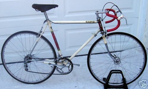

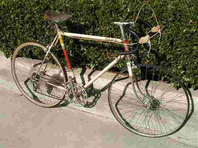

What a neat bike! I can't help but notice that it has randonneur-style bars on it. I've got those on my Carlton Continental that was originally sold in Beverly Hills around 1950, and have seen them on another Carlton sold in that shop in 1958.
Was there some kind of popularity surrounding rando bars in 1950s America? They seem to be out of place on all of these old road bikes...

Those rando bars were added by one of the po's along with the Schwinn approved brake and "safety" turkey levers for a more upright riding position, they have been swapped out for some more acceptable bars and the original levers.

Yep, many variations, most companies had one, Cinelli, 3ttt, many others. Seems like they were quite popular and a lot of different designs. There are several pics showing Major Taylor riding with the bars above the stem as well.
-Gregory
-Gregory
Always interesting searching quality old pics of the era and pro racers. When zooming in one may spot a few with rando bars, various shifters, etc..
