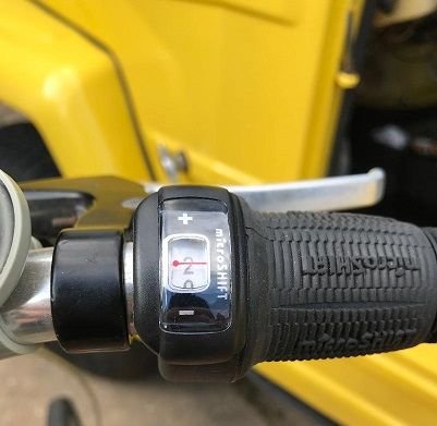

Okay, we had one nice day before it gets freezing again, so I had to take advantage of it. I'll say it was a really great ride, and after 15 miles of city biking, I really like it as a bike. And it wasn't quite as bad as I feared going up and down the stairs. But the fold / inability to stand it vertically without tipping over is still a little annoying.
I will say it's a little odd to me though. I've been using a 2-speed Automatix with a coaster brake for the past 5-6 years. So having control over my gears was a little weird, and just some of the things I've gotten used to (like leaning back on the cranks as I slow down) as well as the front suspension which is new to me definitely had me feeling slightly off balance.
Crazy though how a bike that's cheaper than my previous one really does feel more high end though. Definitely a better hub, and the belt drive feels great, and even just the handlebars feel nicer too.
