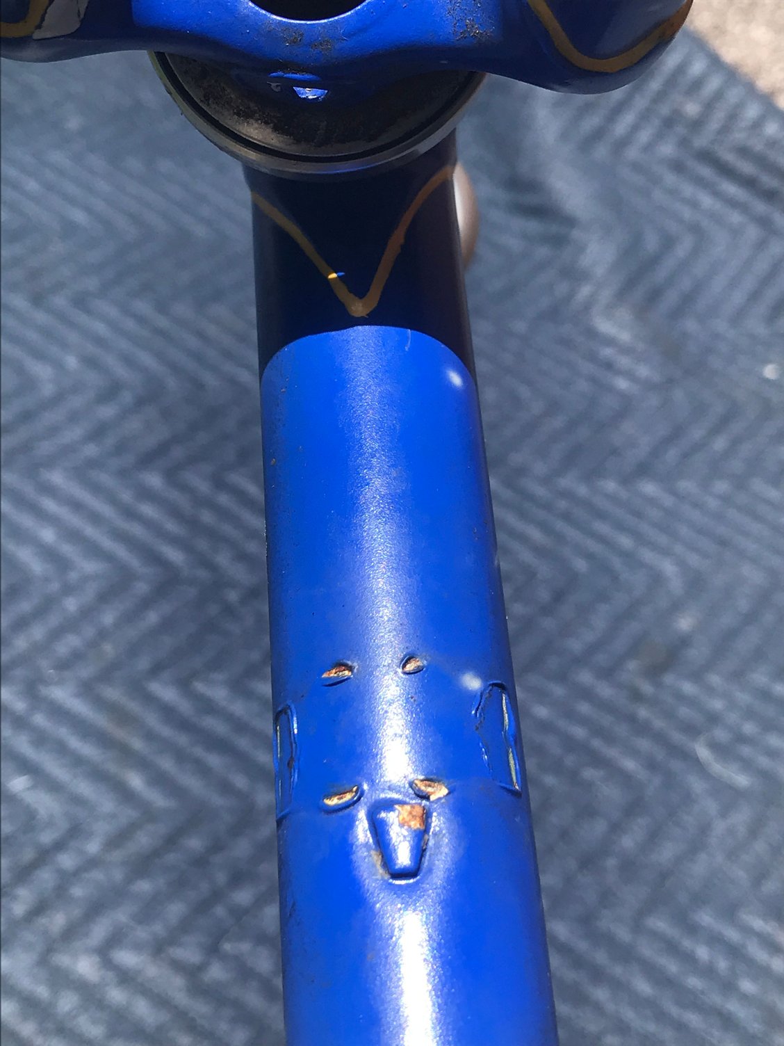

I did not view all the detail pix until now, but I agree this does appear an earlier frame (but not earlier than some Shimano bits were available) which may have had braze-ons added afterward, but could be a home-build or student frame-builder project as well.
Is that a University of South Carolina license decal on the back of seat tube that was masked off before the current paint job?
If so, odd to think the owner thought it important to preserve this decal.
Paint is odd too: lug-lining pretty shaky but someone with an airbrush sure liked making stars!
Any of our Oregon members reco the BB stamp as typical for a Driver's License? I think that's a good theory!

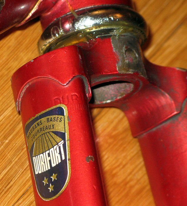

I don't know what I'm talking about here, but did own a Bertin before, for a short while. That seat lug said Bertin to me, somehow. 🤔
Love the stars. 😍
Hey, are you gonna keep that Ultegra triple? 😁😉

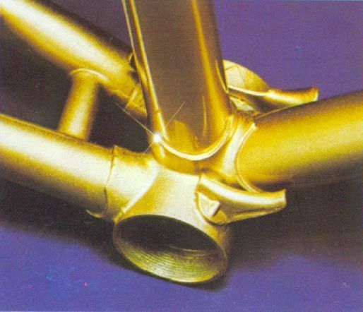

the frame's bottom bracket shell appears to be the BOCAMA Professional
(1979 Gazelle Champion Mondial)
fishmouth mitreing of the four tubes entering the shell, as mentioned above, is a sign of quality
many production frames constructed of first quality tubing simply chop off the tubes square so there is not full engagement between the tubes and their respective shell sockets
also we can see from the images provided that all tubes are seamless

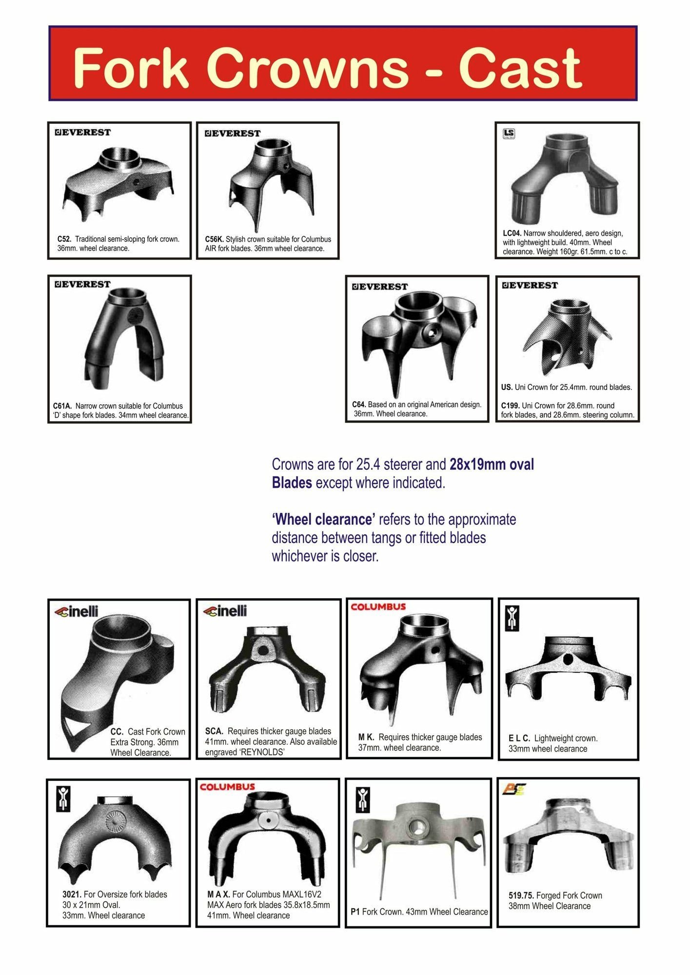

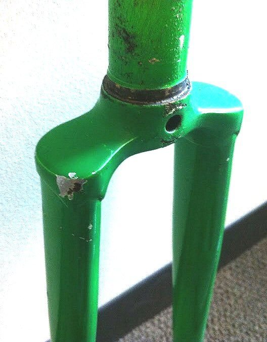

crown
several makers feature the raised round seating pad for caliper brake mounting seen here
have not as yet found an exact match
one maker who features the pad on some models is Everest
perhaps DCI MauriceMoss shall be able to enlighten us upon his next forum visit

There's a brazed on band stop on the underside of the downtube. Cable stops on the headtube are later additions, and I suspect all the other brazed on fittings are as well.

The fork crown looks like a Bocama from the late 70's
Or perhaps a Prugnat... but there were so many crowns that had that look?

I also agree that the mitering inside the BB and silver brazing makes this a US or Australian custom. I lean towards this being a student frame. The less-than-beautiful seat stay treatment looks like student work before they have gotten their aesthetics worked out yet. The nicely sculpted and shaped seat lug with braze-on binder bolt says custom too. The threads on the binder should be checked (if indeed there are threads).
