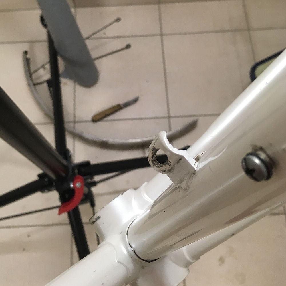

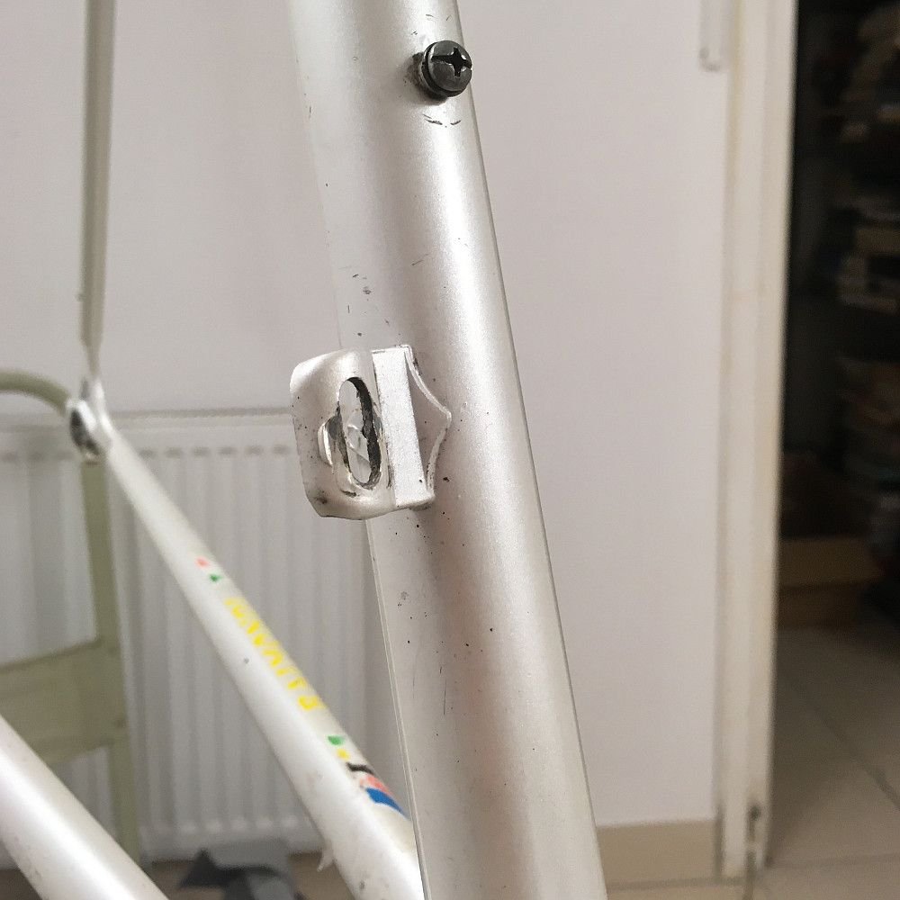

Cheers. Below are some pictures of the mount. It seems they are made up to the standard / curved / convex as per the Campagnolo tab from the above picture.
Front derailleur mount -- 1
Front derailleur mount -- 2
