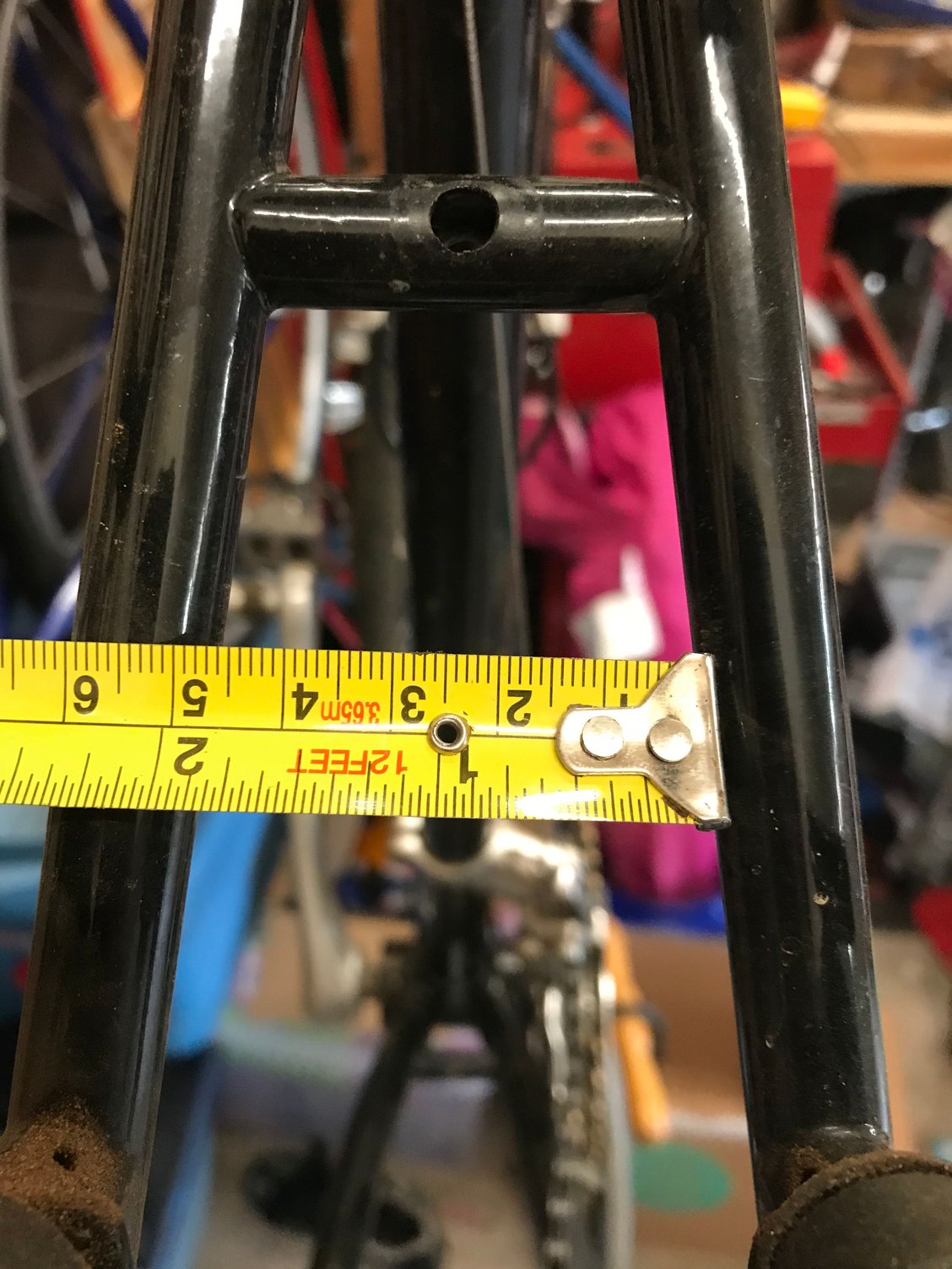

Ok, measurements of my 91 volpe.done with a steel tape, not calipers, but should give a rough idea of clearance.
Chainstays look close to 50mm
Seatstays seem to be the tight point, around 45mm
now, I’m not sure how the frames changed thru the years, so your experience may vary.
