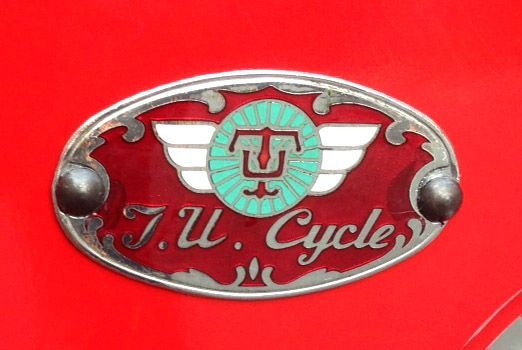

The letters "TU" were used extensively in Tsunoda's marketing campaigns that were apparently very successful in Japan (if you search Japanese blogs you'll run across many people remembering the "Tsun, tsun, tsun, Tsunoda" commercial jingle).
Maybe some Japanese speaking members could chime in on this (as I don't speak or understand Japanese), but in the commercials I've seen, 'TU' usually seems to be pronounced a bit like 'teh-you-go'.
The only explanation of "TU" in Tsunoda's badges and branding that I've ever come across (and that's both on the Japanese wikipedia page for Tsunoda and on a number of random Japanese blogs), is that it's the first two letters of the original spelling of the name - TUNODA. Here is a Google translation of the paragraph on the Japanese Wikipedia page:
Here's a commercial for a Sky Lancer, which must have been on every kid's wish list...
Aside from the "T.U" on the Saturn head tube decal here, there was also a logo where the T was behind the U and it looked like this:
A sign with the original spelling - TUNODA, along with the old TU logo.
It was predominant in a TV commercial called "Tsunoda's Tayu (TU)" . TU is taken from the beginning of the company name spelling (TUNODA) when Tsunoda was founded. Nobuyo Oyama sang the CM song in the CM of Doraemon Bicycle, Dorami-chan Bicycle, and Sky Lancer, which was tied up with " Doraemon " . The name of the wife of the Tsuki- san family in " Dr. Slump " is taken from here.

It's possible that one of the existing decals may be a tubing decal. It was fairly common practice for the bicycle manufacturers to apply their own tubing decals, as it gave the impression that the bicycle manufacturer was producing their own tubing. Sometimes, these tubesets were simply relabelled and other times they were custom drawn to the bicycle manufacturers specs. The only Japanese bicycle manufacturer that actually had their own tubing mill to produce high grade, butted CrMo tubing was Miyata.
Bridgestone and Fuji both used Ishiwata tubing but labelled it as their own brand. Other companies such as Maruishi used a generic label, not mentioning their name or the source. The practice extended beyond the manufacturers, to contract manufactured brands such as Nishiki and Specialized. There were many others in addition to the handful mentioned. The practice diminished in the 1980s, as consumers became more knowledgeable and started to question what tubesets these decals actually represented.
I have seen a Tsunoda Saturn with a tubing decal. It was for Ishiwata 022. Your current post is two sizes under what I would expect for 022 and the seat tube wall would be very thick for an Ishiwata set (assuming the post is not undersize for the frame). Tsunoda is also known to have used Columbus tubing on a few high grade Lotus models that they contract manufactured in the early 1980s. Like Ishiwata, Columbus employed a single butted seat tube and the current post size is small for a butted Columbus tubeset. The appropriate Columbus tubeset based on the post size would be plain gauge Aelle, which I would be atypical for a bicycle of this level. Tsunoda also used Tange on some higher enf Lotus models of the era.
One thing that you can do, to increase your confidence in the tubing manufacturer, is to remove the fork. Typically, the steering tube will be stamped with the manufacturers logo and, if it's a stock fork, it may even have a date code. It's rare to mix fork and frames from different tubing manufacturers at his level so if the fork is Tange, the frame almost certainly also be Tange.
The 1980 Lotus catalog at least corroborates that the subject bicycle is pre-1980. as the EXK version (with the chromed lugs) uses the Dyna-Drive crankset and pedals that were introduced that year.
Wow, I really can't thank you enough for all the info.
At some point I will definitely be disassembling the whole bike to clean and service it, so I will be sure to check the steer tube 👍
