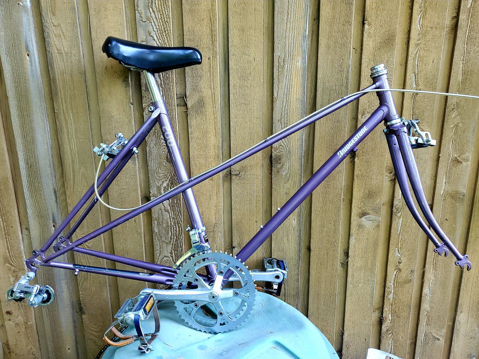

So, I am seeking assistance from the experts here. My twenty year old kid is commuting about nine miles a day by bike(during the nice summer weather). Currently she is riding an old Diamondback mtb. It has worked pretty well, but it's heavy.
I've had this Bridgestone frame for too many years, taking up space. The plan is to build a cute and comfortable commuter bike. It will have 27 inch wheels(read: freewheel), and have an upright sitting position.
I have:
Frameset
Wheels
Derailleur(s)
shifters(thumb or bar end)
coupla stem options
She rides the Burke Gillman trail(MUP) to work, so there's no roads to worry about. At the moment, she's using a messenger bag to carry lunch, laptop, and a jacket. I am not sure about a rack yet. I'm thinking maybe a front basket, or rear rack/single pannier.
I'm looking for some opinions/advice on the following:
Handlebars
Stem
Rack or basket
Crankset(1× or 2x)
shifters
What would you put together for your kid?
Here's a few pictures of the frame.

Wow, very cool, you're obviously on the right track.
Not much to offer but Northroad bars are popular and they have quite bit of sweep back so any stem in the bin that puts them out there is ok as the bars will bring it back, I would have a rack and basket in case one works better than the other for her and would make for more hauling capacity.
The crank that is on there should be just fine, I would utilize all the parts already there as, well they are already there and pretty decent spec.
I would expect this to have come with 700c and would stick with that, plenty of them with freewheel hubs and far more tire choices and deals.
Can you use the shifters off the mtb she has been riding and is used to, maybe brake levers as well?

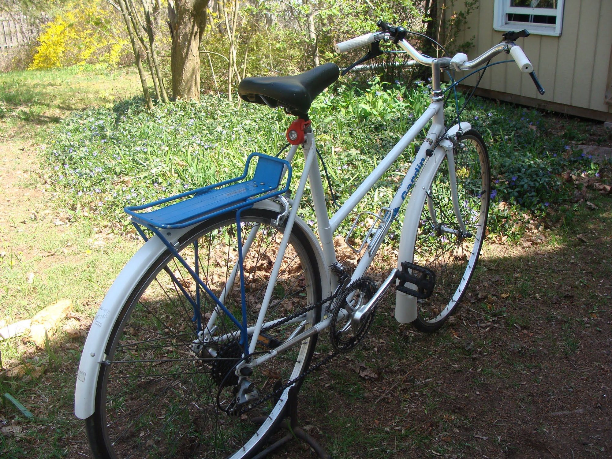

Here's some inspiration just for fun.
A couple of Ms. merziac's, the Moto is slated to get upright bars, and has had the shifters moved to the stem already.
The Paramount came that way so it was a no brainer AND a smokin deal.

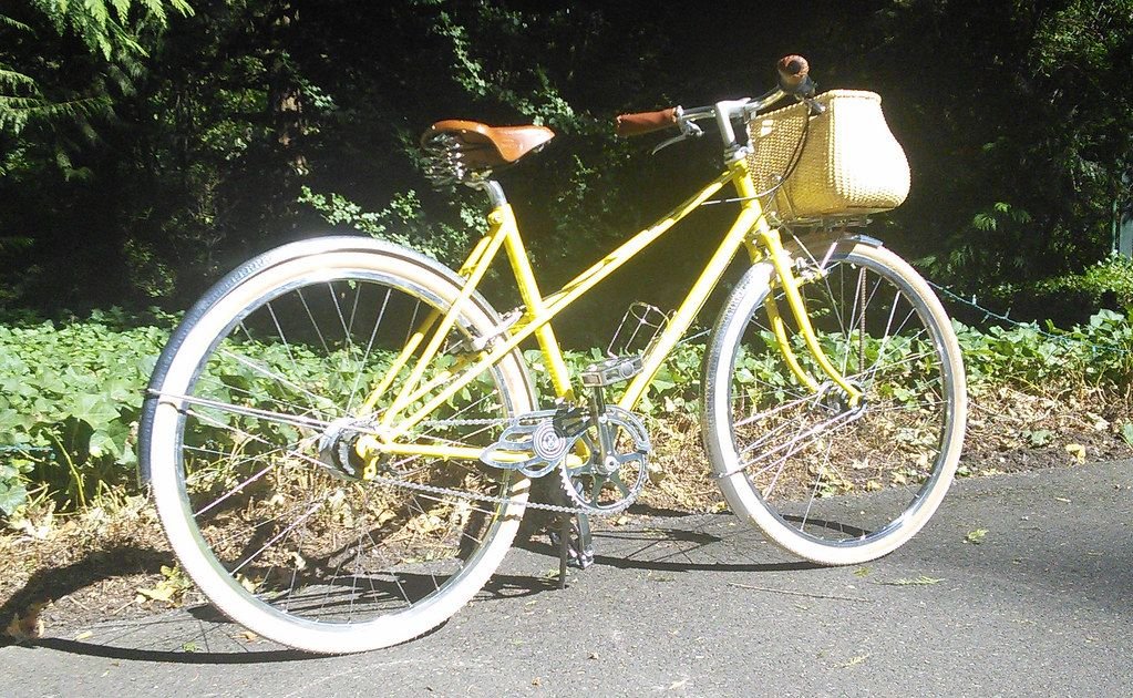

7 years ago I did the same, one of my first attempts at using a torch. An old Nishiki Olympic 12 mixte became this:

Originally Posted by gugie
Sweet, Roger!
That's pretty much what I would like to see in the Bridgestone, Mark. Very nice. As I mentioned above, fenders are not likely, due to her hauling it in the back of her car. I like the IGH, but it probably won't happen this time..
Velo Orange handlebar rack with a bolted on Nantucket bike basket is her favorite feature.
Thanks very much for the offer, Neal. I'll run the options by her and see if she has a preference. The double chainrings will be more than enough for her. She will not be climbing any big hills. Her commute has about two and a half feet of elevation gain...
Roger, here's my wife's mixte, which started life as a drop-bar Raleigh Olympian. While I have those double power stem shifers, you'll see it's set up as a 1 x 6, so the left lever is only for show! Those are Rivendell Albatross bars--very wide!

Here's a few parts that I have if they end up working out for this build.
These are 27" Mavic rims on early Dura Ace hubs.
If thumb shifters win out, these are them.
If I can make it work, these will go on. I need to source a seatpost cinch bolt mounted cable stop/pulley for the rear...
Roger M is offline
