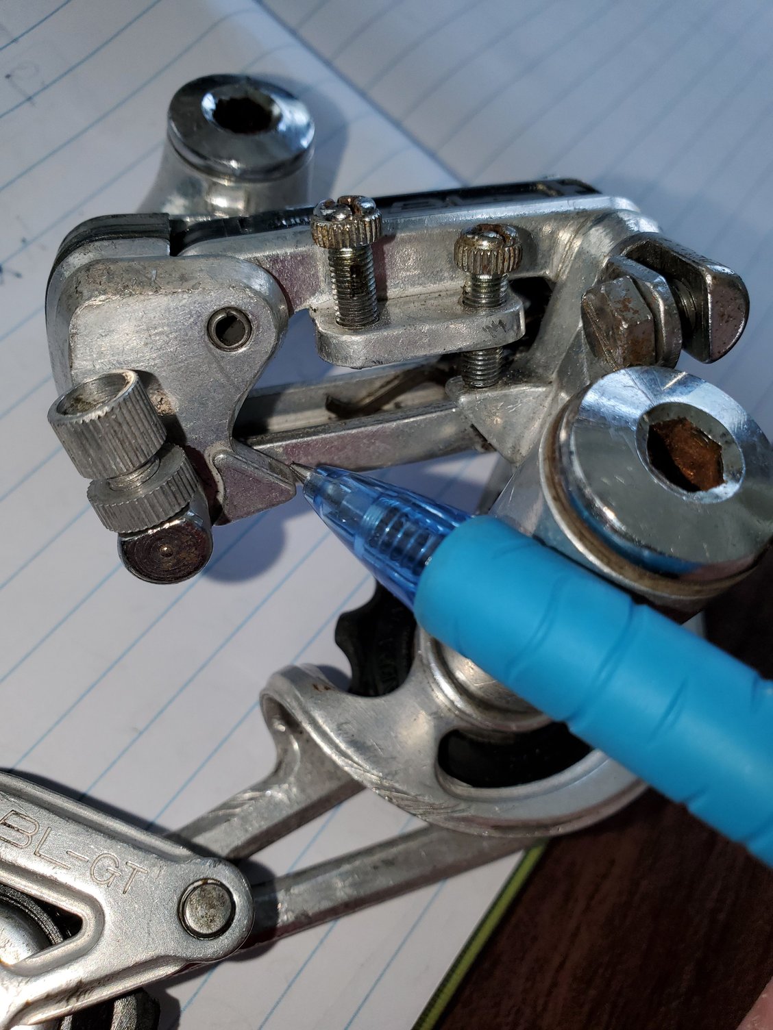

In theory, it is possible to examine the V GT derailleur and identify where the mechanical stop is that limits inward sweep. I'm looking at a BlueLine GT right now to determine where material must be removed. In the attached photo, you'll see where my pen is pointing. This tab is what stops the inward travel at the point where it either contacts the L limit screw or the plate through which this screw is threaded. By removing material on this tab, you can increase the angular sweep. By how much? I'm guessing that you might be able to get one or two more inward cogs of travel.

Smarter folks than me will chime in and hopefully correct me, but I think a lot of the older derailleurs didn't need a lot of sweep since the freewheels were relatively thin spaced and the wheels dished to place the freewheel close to the stays side....probably to keep the hub bearings from blowing up.
I think...
I think...
disraeligears.co.uk/Site/SunTour_GT_derailleur_1200.html
I actually just passed on one at the co-op thinking it was a V GT so I may have to go grab that.

Cyclone Mk II has quite a bit of inward travel. The BlueLine GT (above) has quite a bit as well. Take a moment to investigate whatever derailleur(s) among which you're choosing. Maybe develop a jig of some sort with an M10 threaded hole and some means to gauge lateral movement?

After converting my wife's 77 Raleigh grand prix to 700c with a 10-speed cassette I got bit by the vintage road bike bug. 3 months later I find myself with 7 vintage road bikes in the garage all getting the 700c+10 speed treatment. The first Raleigh came with a (rare?) Suntour Perfect 14-34t 5-speed freewheel paired to a Suntour U rear derailleur. While the stated capacity was only 30 teeth, I knew it worked fine with a 34t freewheel and picked up a 11-34t 10 speed cassette and 10 speed chain. These all worked great and I was pretty surprised to see the stock front chainrings toss around the skinny 10sp chain with hardly any issues. I was also surprised to see it shift to the 34t cog with relative ease.
The cassette/pulley clearance was cutting it pretty close on the Suntour U rear derailleur so I decided to try a Suntour V GT with the longer cage. To my surprise, the V GT derailleur would not even reach the 2nd largest cog with all of the limit screws backed out. It seems the "sweep" (or whatever you call it) on the Suntour V GT is far less than the Suntour U. I also found this to be true of the tri color shimano 600 rear derailleur.
So short story long:
Which vintage derailleurs have the longest sweep?
Any long-cage, long-sweep vintage rear derailleurs?
Can the suntour V GT derailleurs be modified to achieve a longer sweep?
Thanks!

Is there a reason you're trying to make this work with a period-correct derailleur? I can understand if you want to achieve a certain look, but there are plenty of derailleurs that don't look terrible on a vintage frame that are designed to work with 10 speed cassettes. As a bonus, you'd be halfway there if you decided to switch the bike over to indexed shifting.
