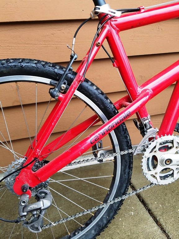

Just picked this up. It sort of fell into my lap for small money.. given the setup it was an easy decision. Haven't cleaned it up.
Anyone know what this thing is?

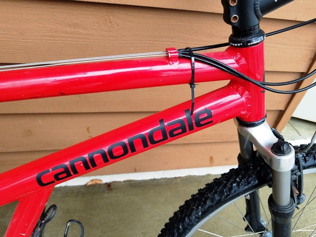

I have a hard time believing it's a Cannondale for two reasons: 1) I can't find it in the catalogs. The shifter vintage(XTR, M951) looks to be 1998-ish. 2) The welds look sloppy to me, given the typical Cannondale finish standards(usually more a carbon frame look with smooth joints)

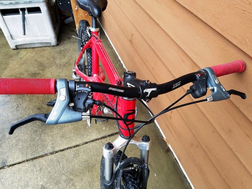

Decals are vinyl and not clear-coated. Paint looks original and pretty decent. Shifters, FD, & RD are XTR. XT crank. Brake levers SRAM 9.0. Hubs are LX (8 speed). Bontrager Maverick rims, 26". Haven't weighed the bike, but it's pretty light..I'd guess ~25#. 17 inch frame C-C.
Any idea on what it's worth? Not looking to flip it..more of a winter project to do something with.

It's not a Cannondale but it's interesting enough I don't know why prior owner would put a Cannondale decal on it. Maybe original make was too obscure to flip. This frame style is older and usually steel.
It kind of resembles the Hawk MA750 in this post but it's got a bigger steerer
https://www.bikeforums.net/20858391-post6370.html

Cannondale has made some weird stuff over the years but I’d agree this is not a Cannondale.

At first I thought maybe a Nishiki Alien that had been upgraded. But the bottom rear seats are different and they didn't have the underneath bottle cage. So not much clue other than it was likely built in the early to mid 90's and had some if not most of the components upgraded at some point and may have been powder coated at that point.. Nice interesting find though if you got it at a good price you did great it has at least $200-300 in nice components hung on it whatever it is.

I've seen lots of elevated chainstays models with that basic, straight tube frame design, including several in aluminum, but don't recall any with tubes that oversize, which was typically the domain of Cannondale and Klein. However, it does not appear to be either. It looks like this frame was designed for a top pull front derailleur (i.e. I don't see a cable redirecting pulley or associated boss below the front derailleur), which Shimano introduced for the 1992 model year, so it should be no older than that. The threadless headset would place it slightly newer but it could be a replacement. Looking at the serial number(s), it's tempting to say 1995 but my recollection is that the elevated chainstay era was passé by then. The complex serial number system is reminiscent of Cannondale but doesn't match. However, for that reason, it does strike me as a possible USA product and/or someting from a larger company.

I admire your choice to remove the decals. I agree that it is likely to not be a Cannondale and therefore should be stripped clean. Hope you do find out its maker.

The triangle is so early 90s and everything else is so late 90s. What a weird bike

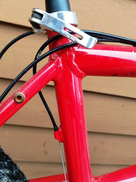

Serial number location on the dropout doesn't conform to any known C-dale:
https://vintagecannondale.com/info/serial_numbers/

Cannondale never did have an elevated chainstay bike. They did go off the rails a bit with the "Killer-V" design for hardtails IIRC -- the design made sense for a suspension bike, but the hardtail was a head scratcher
This is an odd conundrum --- Alpinestars made an elevated chainstay bike , the Al mega, as did boutique makers, Mantis and Yeti, but the rack mounts on the seatstay make me think its not from a boutique- y builder

The hand stamped numbering on the flat of the dropout would seem to indicate a smaller manufacturer. Best I can make of it is likely the date 1995 O6-June 02 25th in the build series 601 and 48 likely mark the tubing and size for the frame parts which were likely stamped before welding assemble. Which would seem to indicate a fairly small operation since most of the smaller start up MTB and BMX builders from the 80's to mid 90's boom failed and there builders are long retired not likely to find much info on this one.

There are a couple other differences - the shape of the weld where the chainstays meet the down tube, lack of upper rack mounts. Otherwise the shapes of the frames are very similar.
