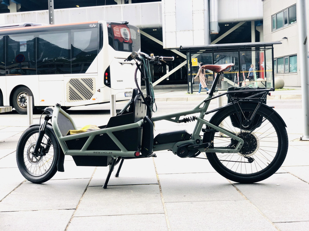

For R&M Load owners, do you know what the diameter of this top tube is? I've been looking at various reviews but can't quite find out. What do you even call this? Handlebar stem top tube?

I actually took a screenshot from Propel’s video of the Load 60 and circled the part I was trying to mount it to. However, this is only my 2nd post so it still wouldn’t let me upload lol maybe a few more replies.
So it wouldn’t be mounted vertically flat on the bar. It would be mounted with a RAM bar mount to a 6” extender that takes a ball head Quad Lock mount with a vibration dampener. So the phone (in theory) would be diagonally facing me. My issue with the Bosch Nyon is the turn-by-turn is much much slower than Google Maps and I like the dynamic nature of Google Maps on my phone (I can add a stop, remove a stop, get suggestions on faster routes, get notifications of accidents, etc).
My original question of finding the diameter is that the RAM bar mount has different sizes. I think the Large would be my fit (should fit a diameter of 1.25” to 1.5” bar). So hopefully that will work.

I have the 60 and the 75; I'll go measure and let you know.
What I normally use is mounting systems with stretchy rubber straps that adapt to whatever diameter for holding stuff. You can use hose clamps or whatever too, but it's nice to be able to take things on and off easily without tools and without messing up the finish.
Likes For MtlClimb:
Hey MtlClimb ! The assembly is the same on both bikes; the lower section is 40.5 mm at the bottom tapering to 40.0 at the clamp, and the upper tube is 34.9 mm, which is the same as the seatpost diameter. Hope this helps.
