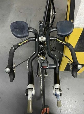

Yes, very helpful, thanks. For some reason it hadn't occurred to me to put them on the end of drop bars. They look like normal brake levers, yes. They're Syntace triathlon bars. I think now I'll try your suggestion first. The bars I select would need to be perfectly cylindrical to fit the leavers, would they not?

Thanks. I put the same album twice I think. See Gallery->Recent. It's the Principia bike. If someone could please post the 6 photos in the gallery here, that would be great.

Image assist for Escuta.
Well, you are a fortunate fellow! You CAN use those brake levers and those bar-end shifters on a dropbar without any problem at all. You might even be able to use the existing cables as they appear to be long enough.
Good luck and cheers.
