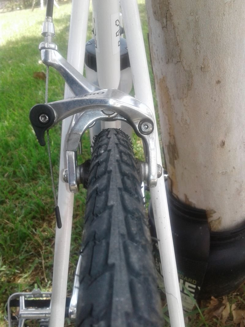

Hey... I get ta post another picture of my late 80's Peu Dolomites. Here its right after a dusty torn up asphalt ride running 700-28c Continental Ride Tour Tires. It could easily run 32s.
Yep... I know the set up looks strange! Especially that seat and those Bars... Ha... The things ya gotta do to keep riding at age... Pitiful...
