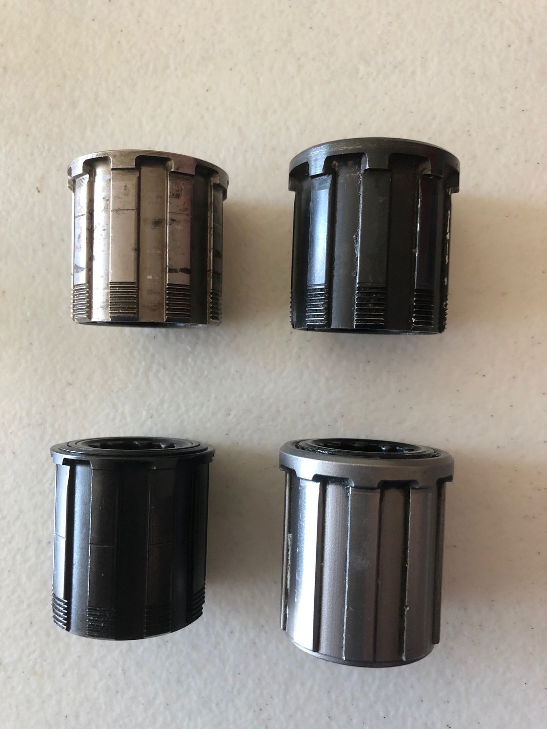

If your wheelset has 30 years of use and worn out so that you will have to replace it soon anyway, get a new wheelset with an 8-10 speed freehub body and keep the project moving. If you have an excellent wheelset with little use, you might want to consider swapping out the freehub body for one that will accept 8-10 speed cassettes.
I have found that it is becoming increasingly tougher to get a "good" rim brake 26" wheelset. I'm not talking some generic co-op set, or maybe a get lucky with a higher end one sitting around, but an older XT/Mavic, or equivalent, that has little to no use. I'm not saying you can't find them, but they are getting pretty pricey. I'm thinking around $200 for something decent. I'm sure there will be stories of paying $50 for some XTR set, but unless you have connections or get lucky, new 26" rim brake wheels are not very high on most mfg's list of things to do. Buying used may be just getting someone else's problem. I bought a new Rhyno LIte (which isn't really light) and T610 hub wheelset just to have around in case I am pressed to need something. It cost a little less than $200 shipped.
If you swap out the freehub body there are a couple of basics that have to do with a shallow flange or a deep flange. I swapped out my 7 speed on my DX hub with an NOS Ultegra 6402 8 speed freehub body (will accept 9 speed) and an NOS axle for DS cone for around $60. Here is a pic of the different flanges.
