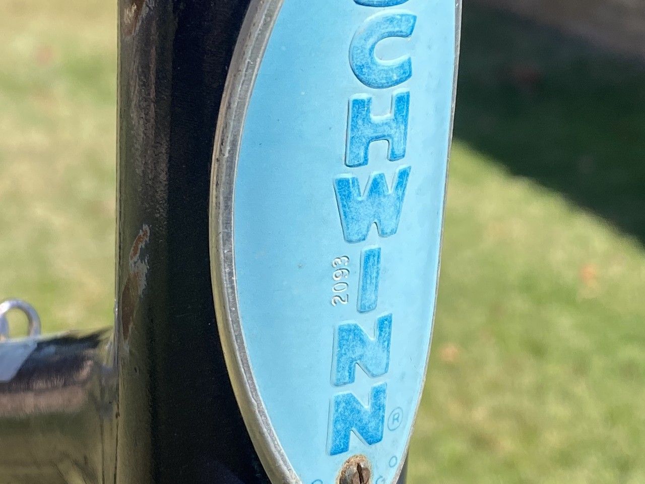

Squinting to try and read headbadge number - 2093?
Should be July 28th, 1983 - first three numbers are numerical day of the year 209 = July 28th , last number is year 1983 (have to guess decade)
I guess I'm never too old to learn something new. I never noticed that number until you pointed it out.
