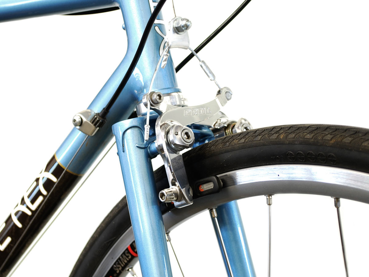

Oh, one other data point. I have Paul centerpull calipers on my main touring bike, and they are mounted on posts. They are very stiff. They might brake a smidge better than the MAFACs and Weinmanns as a result.

They’ll likely perform the same as a set of mafac or any other centerpull using brazed on posts. Since they are directly based on mafac. Which isn’t a huge amount better than center bolt mounted ones, just lacking the annoyance of keeping them properly ‘centered’. I’ve never tried the compass model but I’ve held and handled a set. They don’t seem any different from a set of mafac’s beyond better fit and finish. Same goes for the grand bois centerpulls. The only set I’ve personally used, that seemed ‘different’ was the gran compe gc450’s. Not ‘better’, just different. Likely because they are smaller, a little more ‘aero’ and utilise a single piece spring. Although they can be converted to post mount. They’re all 1:1, and they’re all going to exhibit similar flex, which can be reduced with post mounted setup. This means most centerpulls, especially if they are of the typical ‘mafac’ design, will perform roughly equally. Not taking into account, your cable setup and brake pad choice of course. My personal opinion is that for the money, you’re really only getting that better fit and finish. It won’t get you better performance. If it were my money, I’d sooner buy their (overpriced, but well made) replacement hardware kit, and refurbish a set of mafac’s.

All of my older bikes have their brakes mounted through a single bolt. And like you, I remembered old Weinmann brakes as being very flexible, but the Vainqueurs I put on my Motobécane are actually quite firm, and certainly brake as well as any other rim brake I have (including double-pivot Campagnolo.) Perhaps I had used cheaper Weinmann calipers in the past, or the brake pads were worthless. I dunno! But I am happy with them now.
Mafacs can be found at reasonable prices used. The compass bits run $125 which means that the total cost will be somewhere in the neighborhood of $150 plus depending on how much the racers cost. I doubt that OP wants old brakes on a new bike though. Still if the arms are polished, this would look spiffy!
https://www.renehersecycles.com/shop...erpull-brakes/
I like this 2016 (!) review of mafac brakes in cycling weekly:
https://www.cyclingweekly.com/news/l...-brakes-206323
Modern center pulls are just expensive (the dia compe 450s, paul, or compass) run $300 on up for a pair. The "cheapies" are the dia compe 610s at $170 the pair. That's about the same price as the mafac racers with the upgraded hardware.

The compass, the grand bois and the mafac will all give you pretty much the same performance. All three will have the same simple setup and be very reliable. That’s the blunt truth. So which one you choose is down to your personal aesthetic and wether you’re willing to invest time and money into a restoration, or you want them looking good right from the start. I agree, that for a rinko setup, centerpulls are the smartest choice.

Follow up:
Got the Herse rinko centre pulls. I don’t care about the price. They appear better and note precisely made than MAFACs I’ve seen.
A simple and effective brake. Very well made. From the drops where I mainly ride, they stop as well as my Ultegra hydro discs. Not as ultimately powerful, but somehow more usable. At least in the dry. In the wet, I need to anticipate more but they *do* stop me—even on long Japanese descents. FromFun the hoods they are not so good, but fine for my purposes. Excellent for rinko and plane travel.

Are Mafac Racers "converted" to braze-on style by using the René Herse kit. Or do you have to have an actual braze-on Mafac model?
I am taking a frame building course next month and building a Randoneur but I was planning cantilever brakes. But now ...!

Thermionic Scott. My apologies for late follow up: my brakes are on braze-on posts
Likes For Big in Japan:
I have the Grand Bois brakes mounted on brazed on posts, and they are excellent if not perfect.

I believe René Herse c/p brakes will clear a 54 mm tyre without mudguards (fenders). Write to RH to check. I think they’re modeled on MAFAC Raids, so they should fit a similar size.
Join Date: May 2019
Location: Australia
Posts: 25
Bikes: 1 x carbon Domane (broken after a minor fall); 1 x custom steel (unbroken after being doored at 30 kmh)!
Quoted: 5 Post(s)
Liked 2 Times
2 Posts
